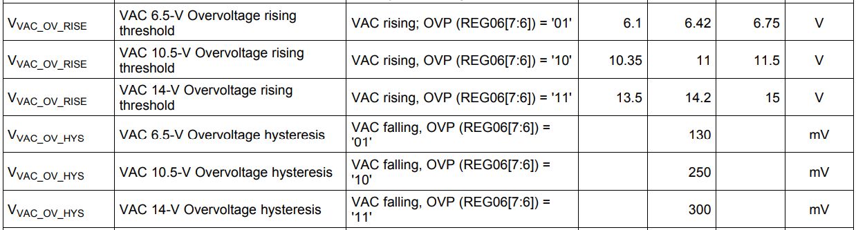

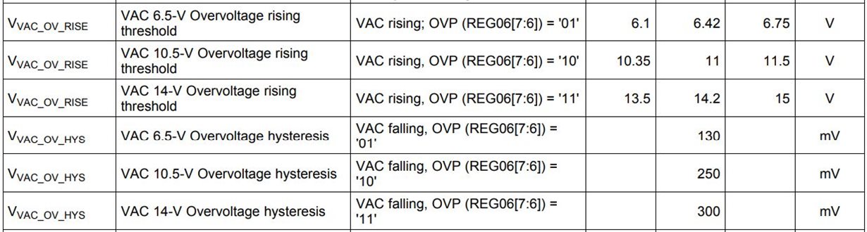

BQ25600D: Accuracy of VAC OVP threshold at 5.5V setting
Part Number: BQ25600D
We can set the VAC OVP threshold to 5.5V (REG06[7:6]=00) but there is no min/max value in electrical characteristics. Is it also approx. +/- 5% that is similar with other setting? And also I'd like to know the its hysteresis at 5.5V setting.
Satoshi
  • Satoshi-san,
    The parameters you are asking for were not characterized as not shown on the datasheet. The typical value we measured is in the similar range of +-5%. The hysteresis is about 100 mV. These numbers are for your reference and are not warranted.
