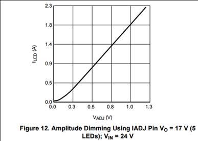

    My customer used LM3409HV for LED driver, they used IADJ for dimming, but they found when PIN IADJ connected GND, the output current still has 7mA, the PIN PGATE also has the output to driver MOS, customer hope when IADJ=0V, there is no output current.
    I found the graph of datasheet Figure 12, when IADJ=0V, the ILED is not 0A, so does used IADJ dimming the current can't be 0A?
    Please help to check the problem, thanks!
