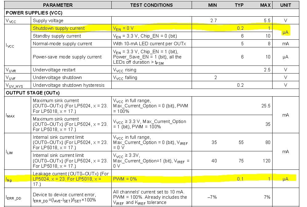

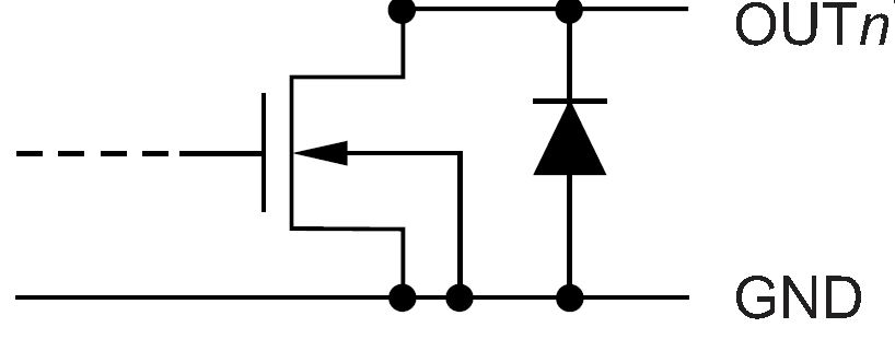

Hello E2E,
As the title suggests, are there protections diodes from the OUTx pins to Vcc?  Anything from OUTx to GND?  Is there any cause of leakage that we need to be concerned about outside of the spec'd 1uA max from the datasheet?
