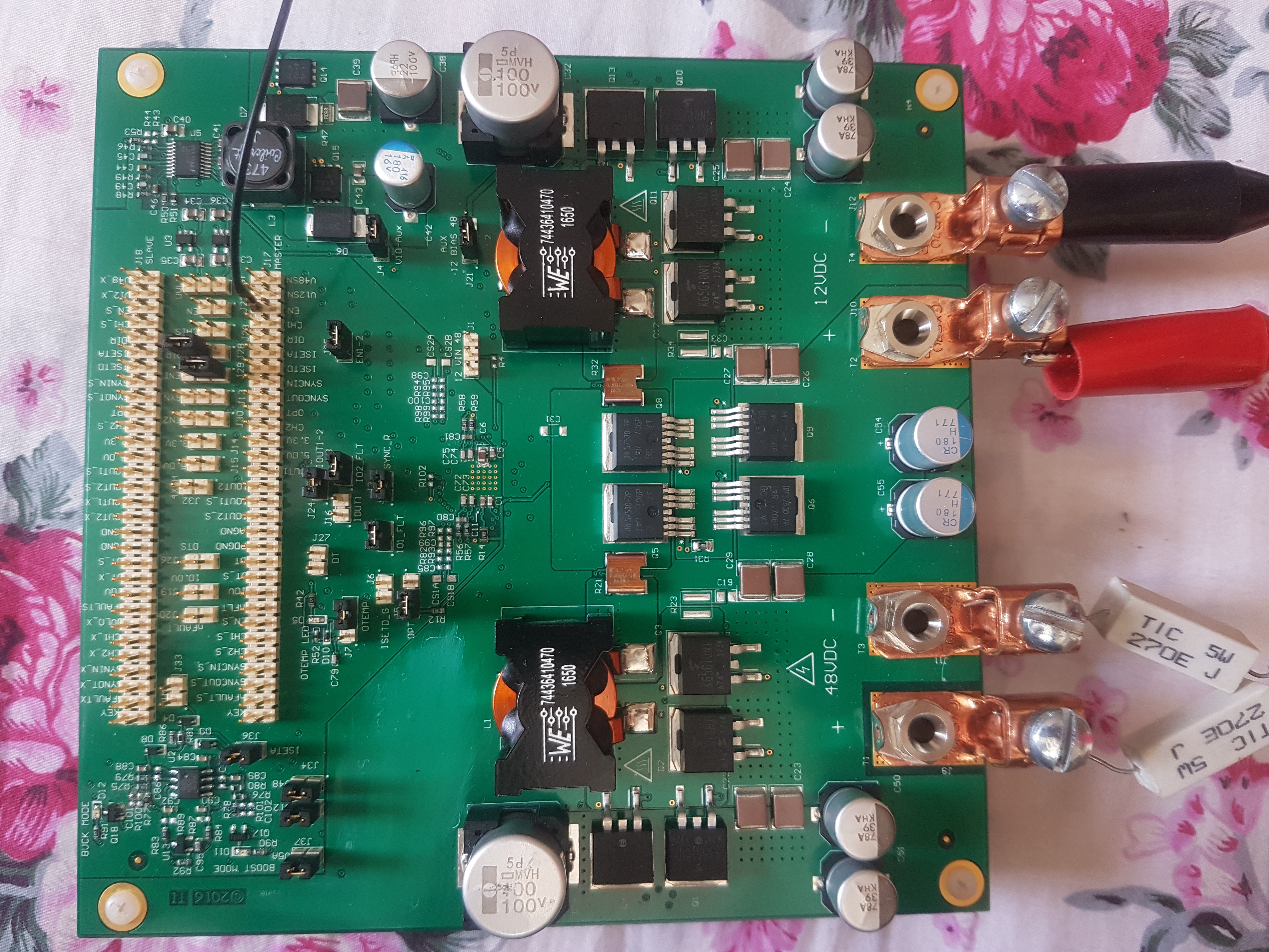

  I am using the LM5170EVM-BIDIR as Boost mode see below attached Picture for Jumper settings using on board Voltage Loop for 50.5V O/p since i have not connected any O/p Battery at HV-Port and just connected a small load of 540Ohms i have shorted the circuit breaker at bottom 2 pads and connected Jumper J3 too:
Now when i provide LV-Port as 12V i get o/p as 50.5V but keeping all settings same when i provide 48V at Lv-Port i just get O/p as (I/p V - 0.7V) = 47.3V instead of 50.5V. Can you explain what have i done wrong? I have also changed resistor Rovpb to 24K from 54.9K to accept I/p 48V as input to LV-Port but still it is not working. Deeply awaiting your reply.

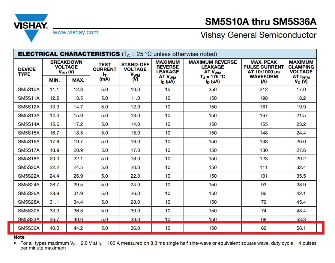

    Please be aware that this board was not designed to operate at 48V on the low voltage side. Components like D3 might be causing the issue. This zener diode is going to try to clamp the LV port to 36V. Please remove this diode.

     2.> For D3, i just tried to connect series Amp meter in Input LV port providing 48V to check current going through D3 with no load at O/P it had a initial surge of 2A-2.5A  for <1 sec and later dropped to 0.5A  (maybe charged the current for capacitor) and reducing slowly even more slowly. Assuming I/p loss of around 0.5A maximum it still maintains 48V as I/p and not dropping to 36V. Also the Clamping Voltage for D3 is 58.1V as per datasheet. Still if you insist we can remove the Diode. See attached File below:

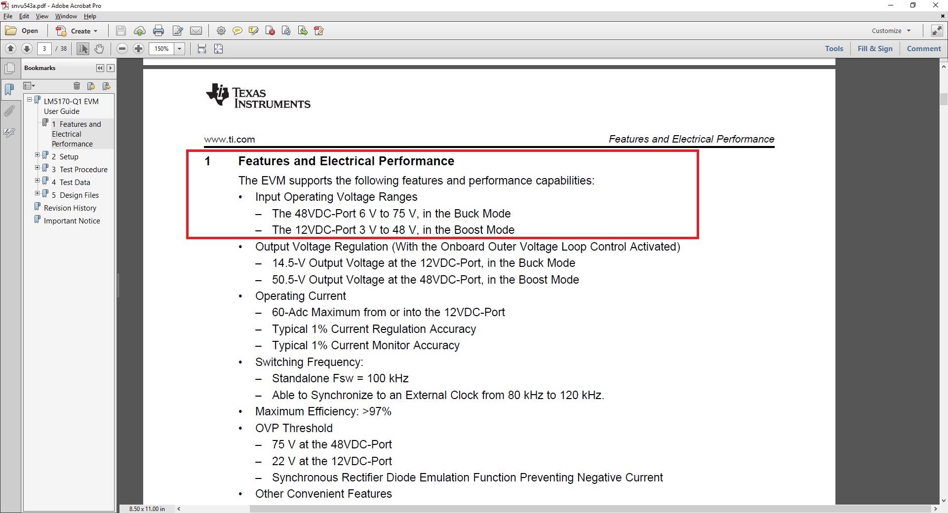

     3.> Please clarify properly when you say that this card was design for LV port 36 only. See attached File for TI below shows operating voltage of LV port as 3V to 48V. It clearly stats "Operating Voltage" and not "Maximum Voltage". Please See TI User Guide Attached Below:
