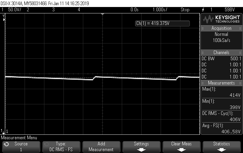

UCC28070: 115Vac low frequency output voltage ripple after burn in
Part Number: UCC28070
We used UCC28070 as PF controller, it's found low frequency(4second) output voltage ripple at low line 115Vac after burn in. It disappeared after add 0.5A loading. As the frequency is low, it should not be burst mode.
Please see attached waveforms. At high line 230Vac, we cannot find the low frequency ripple after burn in. Please advise any parameter may cause it, such as compensation loop?
