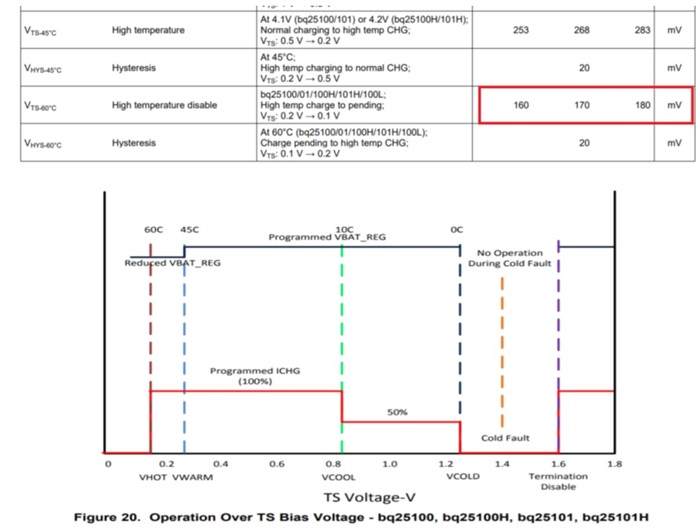

Could you help to know the CHG behavior when sense temp around 56 degree on TS(0.176V) pin.

You can reference our datasheet figure 20 waveform to know more detail.
Based on El table, if your TS pin voltage is around 176mV then in general, it may be in warm condition. So BQ25101 will reduce CV voltage level.
But TS pin detect voltage level also has tolerance, so I think we can't 100% make sure it is warm or hot condition.
