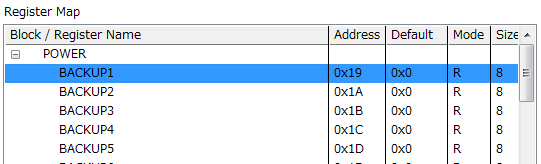

Hi team,
Could you tell me how to access register through I2C? The datasheet shows address (7bit) R/W (1bit) ACK (1bit) Data?(8bit) ACK (1bit), in Figure 5-14.  I assume page selection is included the address (7bit). So, for example, in order to access BACKUP1 in power registers, what the I2C bus protocol is like? For example, 0x58 (page selection) + R/W + ACK + 0x19 (address) +  data + ACK + START/STOP?, or  0x58 (page selection) + R/W + ACK + dummy data + 0x19 (address) + data + ACK + START/STOP or something else?
Thank you for your support.

    Thank you for your comments. What is the mean of 8-bit data that you mentioned above? In my understanding, sending 0x58 can select page 1 (=power registers), it means you can select one of power registers, such as BACKUP1(e.g. address: 0x19, default data: 0x0). How to designate the register through I2C protocol exactly? I assume you should send addresses of 0x58 and 0x19 through I2C protocol, but how?

    If reading, you specify the register address (0x19)
    if writing, you specify the register address (0x19) then the data you want to write to that register.
