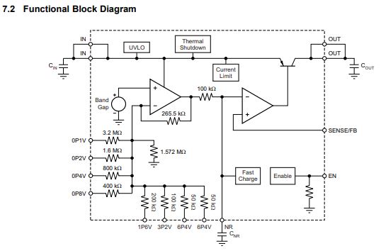

I think TPS7A4701 require reverse current protection schottky diode if Vout voltage level becomes higher than Vin.
In this case, I would like to know required diode spec.
Is forward current spec over 1A is better because TPS7A47 rated current is 1A?
How should we select schottky diode?

    Schottky diode protection is recommended for LDOs with pass transistors capable of conducting current in the reverse (OUT to IN) direction due to a body diode or parasitic diode. Since the TPS7A47 does not have a reverse diode between OUT and IN, it does not require reverse current protection.
    For future reference, instead of choosing based on the forward current rating, a Schottky diode should be selected from the I-V characteristic provided in the datasheet. The diode should have a forward voltage of 0.3 V when conducting 10 mA to 100 mA. This ensures that the Vout is clamped to Vin + 0.3 V, which prevents any parasitic or body diode between OUT and IN from turning on.

    I checked another post about TPS7A47. So it has been described about reverse protection diode.
    e2e.ti.com/.../2615957
    Isn't reverse current protection diode require?

    Yes, the post you linked is correct. I apologize for my mistake and any confusion it may have caused. The TPS7A47 does require reverse current protection if the output voltage could exceed the input voltage by more than 0.3 V in your application. The Schottky diode should be chosen based on the I-V characteristics as explained in my previous response.
