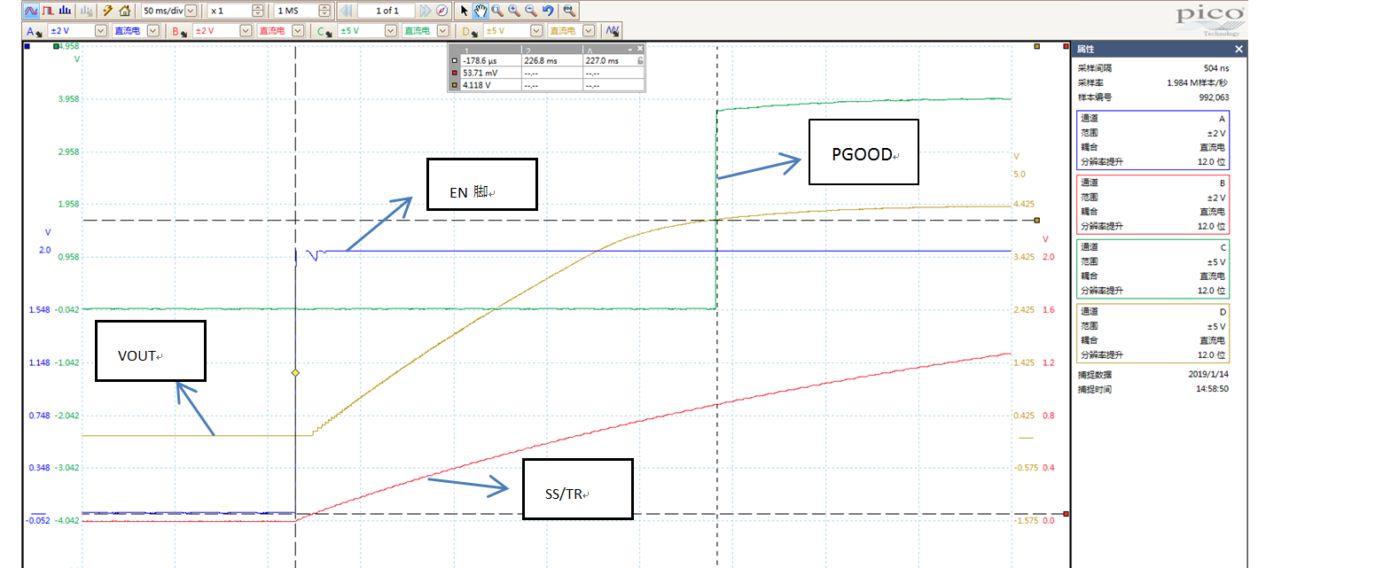

dear sir,
our customer meet TPS54160A Tss (Soft time) test result isn't match datasheet calculate formula。
for example:
Css=390nf, Tss should be =125ms, test result is 227ms,
 if Css=470nf, Tss=150ms,  test result is 251ms.
so customer want to know why these data is so big gap with theoretical calculate.
Tss 's definition from En is high to pgood signal is high, that's right?
