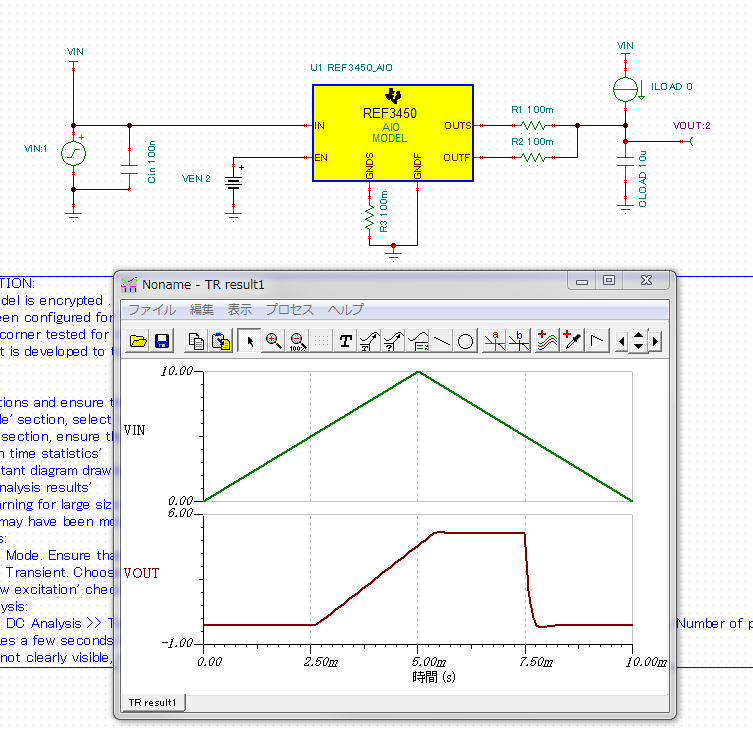

I performed TINA-TI simulation for REF3450-Q1.
Q. As we can see in the waveform, when the Vin increase gradually, the Vout start increasing from @Vin=5V. Is this behavior correct? VEN is 2Vdc.
Q. Customer's requirement for this device is to start increasing Vout from Vin=4V. Is there any solution or other good device for that?

  • Since this is a linear device, the 5.0V references requires 5V + the dropout voltage for any output voltage. I assume the model is defined from this datasheet specifications.
    I would say this would be normal or expected behavior, but after testing this device on my bench,I started to see that the device started tracking the input at around ~3V. Even though the the simulation does not support the customer's request, real life application does.

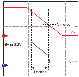

    Thanks, I understood. I know the 5V references requires 5V+ dropout voltage. So in case input voltage is less than 5V, the reference just tracks the input.

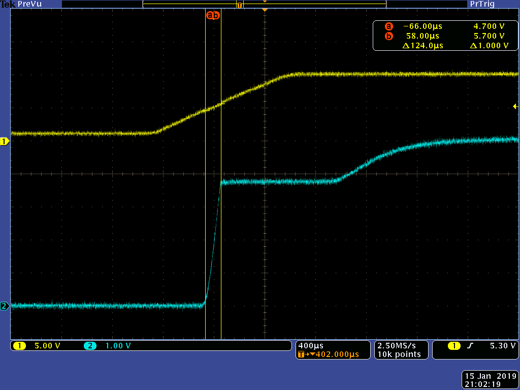

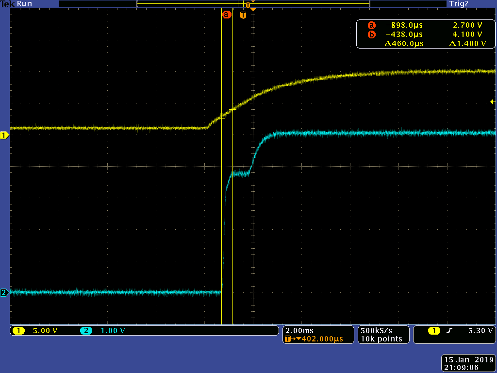

    Below are two scope shots of the input and output of the REF3450. Channel 1 (yellow) is the input voltage, and channel 2 (blue) is the vref output.
    The first scope shot is a function generator input with a 10V /1ms slew rate. As you can see here the quick slew rate causes the REF3450 to start rising around ~5V.
    The second scope shot is from a bench power supply that has a much slower slew rate. The REF3450 starts rising around the ~3V I measure previously.

    Q2. In your measurement results, the Vout become flat at 3~4V and then start increasing again. What is the reason of this behavior?
