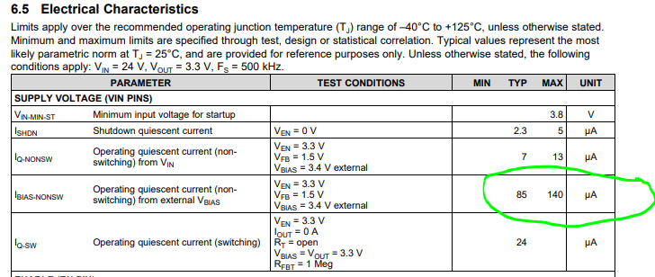

We’re using the LM46001 in an application and were reviewing the quiescent current spec more closely.
  • There is an 85uA_typ (140uA max) specification for Vbias “non-switching"
  • But then also calls out 24uA typical for “operating quiescent current (switching)”.
How can the non-switching Iq be higher than switching?
What is the total quiescent current we can expect during switching operation at no load?
Thank you very much, Keith
    The IBIAS specification refers to the current draw by the BIAS pin when powered by an external voltage source.  The Iq-nonsw spec is the current draw by the input pin (VIN).  The datasheet recommends tying the BIAS pin to the output if VOUT>3.3V.
    The typical no load current in operation is 24uA typical when BIAS is tied to VOUT as described below:
    Please let me know if you have any additional questions or if anything is unclear.
