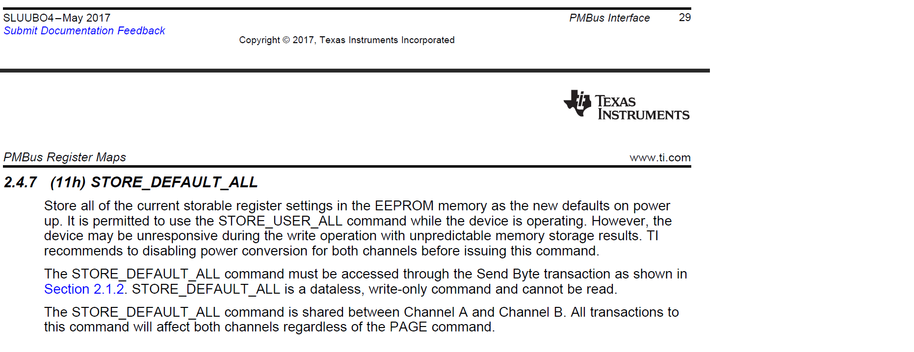

   In the Technical Reference Manual, Chapter 2.4.7 (11h) STORE_DEFAULT_ALL, it said:
    >> However, the device may be unresponsive during the write operation with unpredictable memory storage results.
    >> TI recommends to disabling power conversion for both channels before issuing this command.
  Q1) To do the NVM programming for TPS53681, should we disable power conversion for both channel
        before issuing the STORE_DEFAULT_ALL command?
  Thank you.
Best Regards.
  • Hi Hank, yes. I recommend you keep both VR_EN pins low before issuing Store Default operations.
