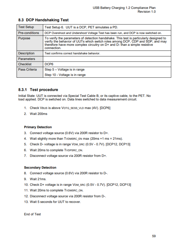

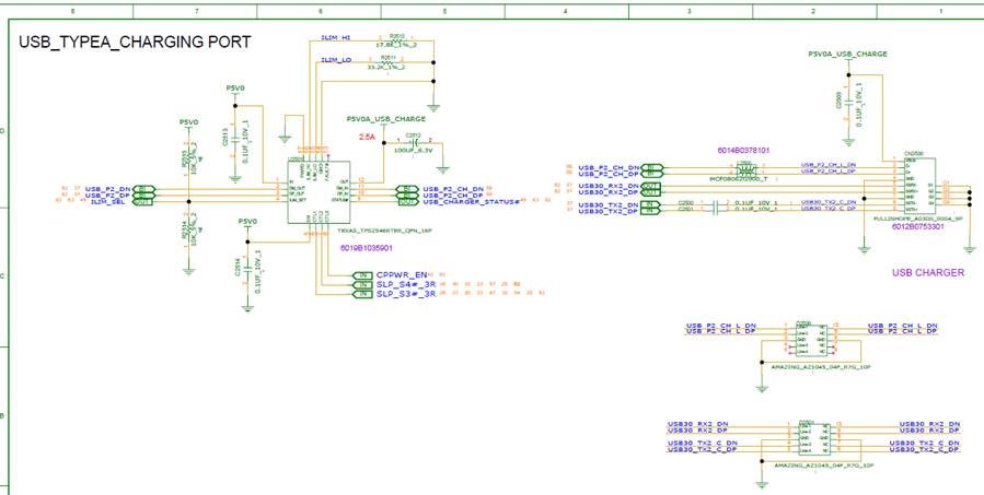

Hi Team,
DCP mode when system in S5 the D+ have to short to D- ,the voltage is 0.5-0.7V but customer got the D+ is 0.6V D- is 1.6V.
setting on CTL1=CTL2=0V CTL3=3.3V when S5. Please refer test procedure below:
