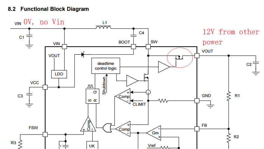

Dear TI:
If TPS61089 Vout=12V, and Vin=0V, If the 12V of Vout will reverse to Vin?
Below is a screenshot of the TPS61089 datasheet, dost the MOS body diode will blocking reverse voltage?
Dear TI:
Hi Eric,
Yes, the body diode will block the reverse voltage.
