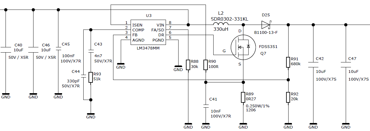

I have a prototype circuit board with a boost converter utilizing the LM3478 switching regulator.

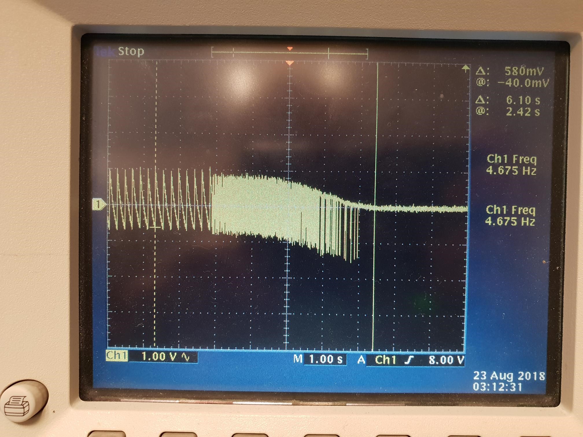

The output voltage on the DCDC has a low frequency ripple on it when no load is connected on the DCDC's output (2V, 5Hz). When the load connected to the DCDC's output is increased the frequency for the ripple increases until the ripple disappears. I have measured the voltage across the MOSFET (VDS) and it seems like the regulator is only driving the MOSFET for a short period of time (Burst-mode?, over voltage protection triggered?).
What causes the output voltage ripple at low loads? Is this a feature like pulse-skipping our is some internal protection triggered at low loads?
*I have attached the schematic below.
Schematic:
