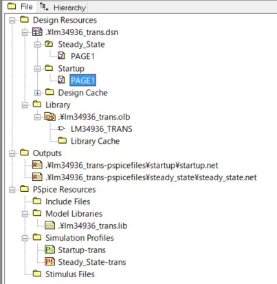

HI, LM34936 support team
I would like to simulate the input line regulation of LM34936 when LM34936 was used at the back of PD controller because it must support the input voltage range of 5V-20V. There is a "LM34936 PSipce Transient Model" as simulation file in product folder. There are 2 kinds of schematics for simulation as follows. But PSpice library is only one.
1. Is the same PSipce libray file used to simulate for Start-up and Steady_State?
2-a. If YES, is the difference between Start-up and Steady_State only the input power supply model?
2-b. If NO, which schematic of Start-up and Steady_State should I use to simulate the input line regulation?
Tamio
  • Hi Tamio,
    The same model is used in both simulation types.
    I believe the difference between the start-up and steady state is just a difference in the test bench. The Input voltage supply setup is different.
    Garrett
  • Hi, Garrett
    I got!
    I have already simulated using the customized schematic based on the steady-state schematic. The input power supply, peripheral parts and something was changed.
    Since I look like that the power consumption on BIAS pin when Vin is lower is not considered, I added a load resister on BIAS pin. I took a waveform as my expectation.
