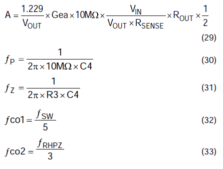

I calculated using the parameters of the circuit example in the specifications, but the results do not match.
Dear Sir,
This is an old datasheet. I think the original datasheet writer made a typo error. In my calculate, output pole is 1040 HZ and the right half plane zero is around 119 kHz.
Thank you for your reply.
Dear Sir,
It need about 1month before we could get the datasheet updated . Please wait in patience.
6332.TPS55340_BOOST_CALCTOOL_REVC.xlsDear Sir,
If you want to calculate the stability, I suggest you use the TPS55340 calculation tool. Please check the attached form. or I can help to calculate it for you if you could tell me the Vin, Vo, Io.
Thank you for introducing the tool.
Please calculate R3, C4, C5 as we will tell you the design conditions.
Vin=12V
Vo=24V
Io=1.5A
Dear Sir,
Rcomp=1.21k ohm;
Ccomp=100nF;
Cp=330pF
