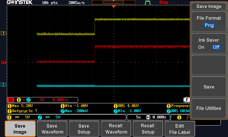

  • Hello Leslie,
    Please find the attached scope results for COMML+- on TOP and COMMH+- on bottom device.
    I am powering up the devices internally using Wakeup signal. Should I power up externally by giving 5V to Vp on both the devices?
    The Wakeup of Top device is quite magical. Sometimes it powers up properly and gets 5.3 V on Vp(Top). Then if I keep the setup as it is for some period of time without doing anything, TOP device Vp voltage goes OFF. Also, on reconnecting the circuit and again waking it up, it does not waked up. I need to wait a long after which It may get waked up again.

  • Scope result across COMMH+- on Bottom device and COMML+- on TOP devices are same.

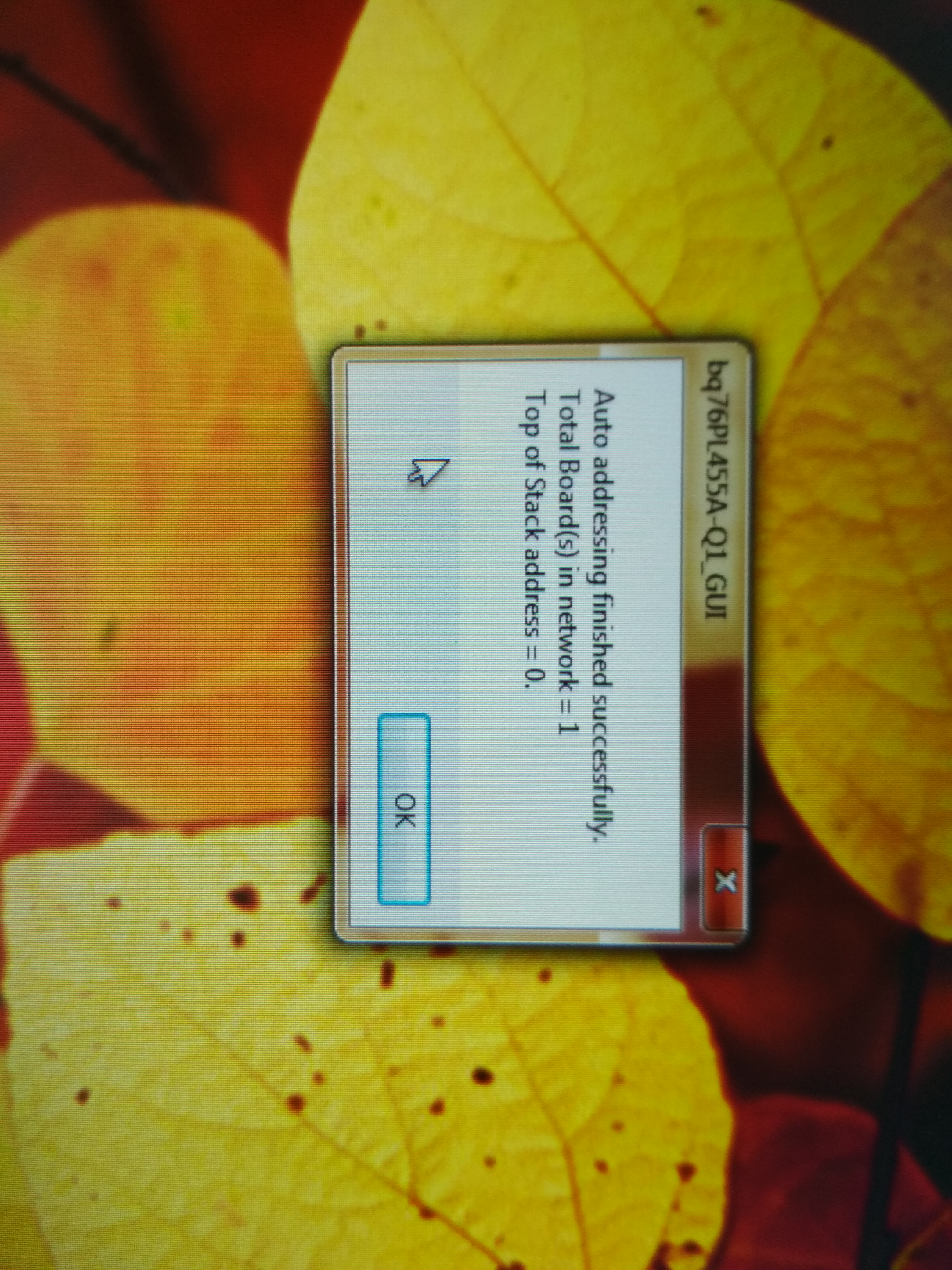

  • Hello Leslie, Taylor,
    I have tested using GUI software for bq76pl455. Only 1 device was detected. Second device was not detected.(Image attached below)
    After manually putting commands for auto-addressing, while reading 2nd device address, an error has come.(Image attached below)

    On your scope plot, can you please indicate what each signal is of the 3 signals plotted? Seems like no data is being sent. Did you capture this after a read or write to stack device? You should see data (voltage levels toggling high and low as data is being transmitted). Can you please capture the plot when sending or reading from the top device?
    Regarding the error you saw in the GUI, what happened is that when you read from the top device, the PC is waiting for a response from that device and it never received it so you get a timeout error.
    Leslie
