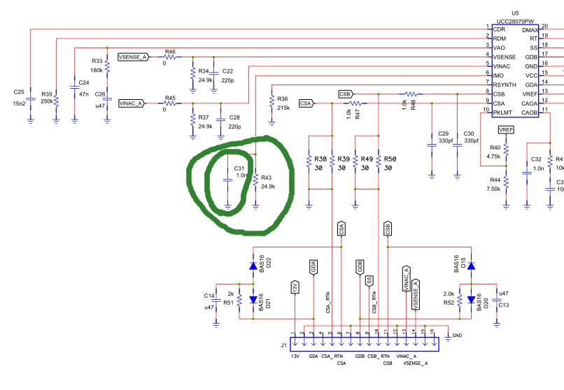

First of all,there is no pwm.UCC28070 doesn't work .I check it one by one. I can't find  the reason ,so I recalculated all parameters.And there is a new question,I can't change 'Dmax'.
If Vin=0VAC, just through the partial voltage resistance Vsense=2V, Vinac=1V, it can be measured under the condition of maximum duty cycle drive waveform.
I set  fs=100KHz,Dmax=0.9  RDMAX=59KΩ . When    VCC=15V   Vinac=1V  Vsense=2V. I find DMAX=0.66.If I set RDMAX=68KΩ(Dmax=0.95),and I test Dmax = 0.6.Why DMAX is always about 0.6. I changed a new UCC28070. DMAX also equals to 0.6.Before  I recalculated parameters, I can test Dmax=0.9.
Beside these, about Nct,I calculate Nct =592. I find TI set Nct= 0 ~ 200.So I set Nct=200. Whether it is right or wrong.My Lct=84mH.
Here is my mathCAD.Could you please take a little time to check my parameter calculation right or wrong ?
Thank you!
NEW3500WUCC28070 Design Tool .doc

  • Hello John,
    Thank you for your reply. Here is my schematic.In this  schematic I don't use flyback power.
    I use external auxiliary power module to supply control circuit power and not connect a high voltage input.
    I run the pfc open loop with VCC=15V, Vsense=1.8V, Vinac=1.1V.
    Question 1: No matter how I change the RDMAX, DMAX always equals to about 0.6. Why?
    Question 2: I saw a case PMP4259  ( http://www.ti.com/tool/PMP4259)  (http://www.ti.com/lit/df/slur294/slur294.pdf) about PFC part.
    Why is IMO pin external resistance in parallel with a capacitor. In TI UCC28070 datasheet I don't find a capacitor connect to IMO pin.

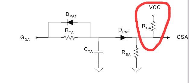

    Question 3:I can't find Roa in (http://www.ti.com/lit/df/slur294/slur294.pdf). Doesn't it use Roa? If so , why?
    Best Regards
    jiannan li

  • Hello jiannan li,
    Your schematic shows an expected pwm frequency of 100kHz and a max duty cycle of 0.89.
    Do you have a scope plot of the GDA or GDB output ?
    If you are not getting a duty cycle close to 90% then either:
    (1) The ic is damaged and should be replaced or
    (2) Your test board is not built according to your schematic.
    I recommend that you disconnect the gate drive resistors R10, R16. Then look at the GDA waveform with a calibrated scope probe, replace the UCC28070 with a good part and check your board and all the component values.
    John
