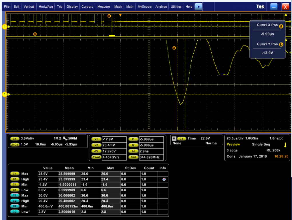

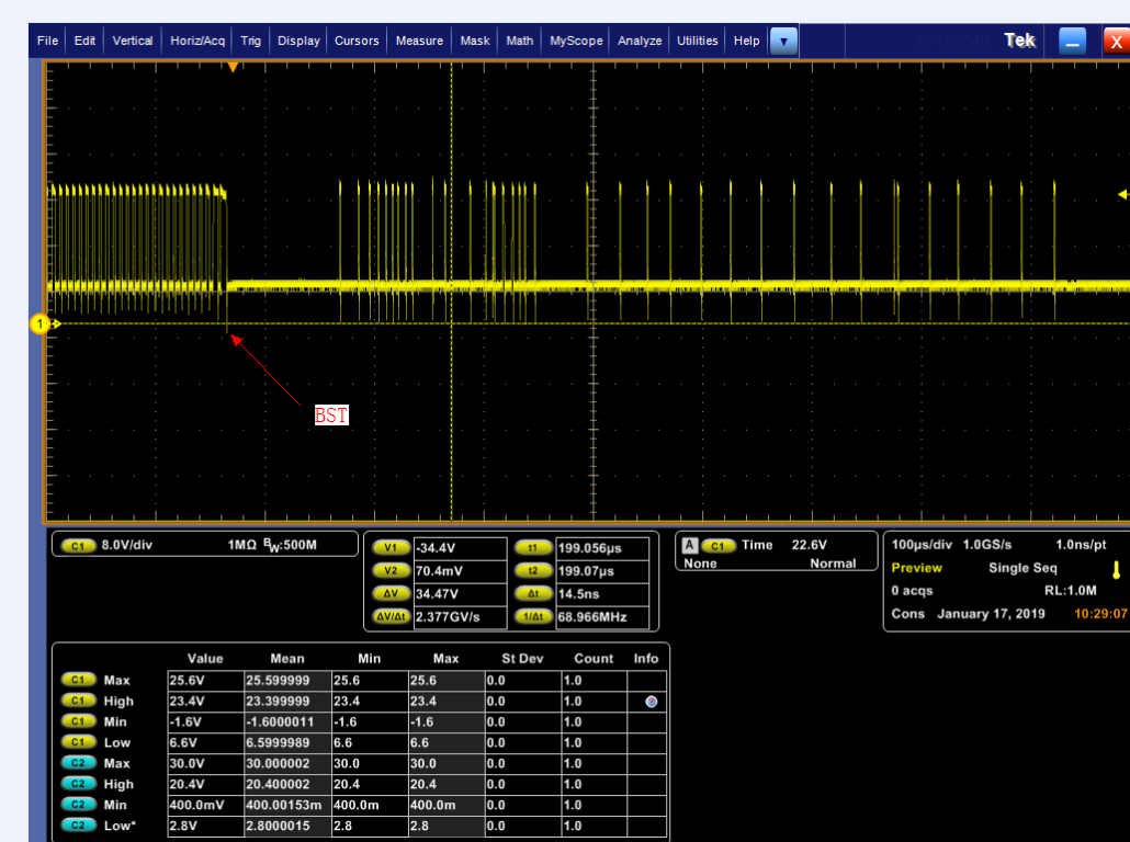

just want to check if it's OK that BST-GND is -1.6V/5.986uS when do Vout short test since datasheet mentioned -0.3V spec.
Hi Given,
As mentioned by email, BST-SW is the key voltage here. The transients in the above plot are very short duration (<10ns), should not pose an issue.
