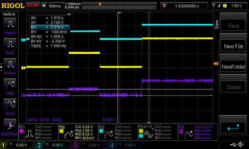

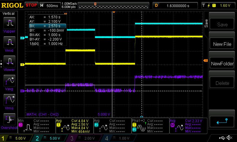

  • Hi There,
    I just wanted to share this attached oscilloscope screen capture with you to see if you any light on what is going on.
    This show the Gate voltage of the DSG FET in yellow, the Soucre Voltage of the DSG FET (Battery Pack output) in blue and calculated VGS of the FET in purple. This image is captured on the first startup of the device.
    The device is woken up with a 1s pulse on PACK and in response to this pulse the gas gauge is partially turning on the DSG FET Vgs = ~2,2V. This partial turn on could in the presence of a multiple amp load cause the FET to burn up.
    Can you explain why the gas gauge is doing this? And how I can stop it doing so?
    David
  • For the DSG FET to be off the gate has to follow PACK. If it can’t, the FET isn’t guaranteed to be off. Therefore, it might be on but also could with a lower gate drive than intended. With a higher resistance channel, the power dissipated in the FET can be much higher than normal if the system tries to draw current in this semi-off condition. The FET damage can accumulate over time since the turn off will happen slower than intended.
    So, please do not deviate from our reference design.
  • Hi There,
    I will certainly remove the diode to be more like the reference design. But I am not sure I am seeing the symptoms that you are referring to. In the scope capture I send above you will see that DSG has no problem tracking PACK to a sufficient level to keep the FET properly off. It seems that the issue is that it decides not to do that sometimes, for example during the startup pulse pictured the FET is being poorly high-side driven so the device is clearly trying to turn it on but is doing a bad job of it. Is there a way this pulse on startup can be avoided?
    David
  • I'm sorry but the drive is what it is. If we filter it, then we may delay the FET switching time.
