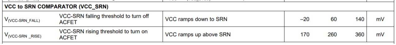

  • Hello Tamio,
    Because the ACDRV is high (to turn on ACFET/RBFET) only whenever ACOK is high, any condition that causes ACOK to go low will also cause the ACDRV to go low and disable ACFET/RBFET.  So, for instance, if the ACDET drops below 2.4V, the ACOK will go low and as a result, the ACFET/RBFET will be turned off.  From datasheet 7.2 functional block diagram, ACOK can be deasserted due to VCC UVLO or ACOVP.  There is also a relastionshp between VCC and V_SRN shown in section 7.3.1.2 that can lead to ACOK deasserted.
    Steve
  • Tamio,
    As Steve mentioned the rule of VCC and V_SRN, it is easy happened when customer design 4cell battery and each cell voltage is higher, may be around 4.4V/cell.
    Customer will easily see ACFET will be turn off during system dynamical load transient due to VCC voltage drops below (V(vcc-srn-fall) criteria.
    Just share my experience before.
