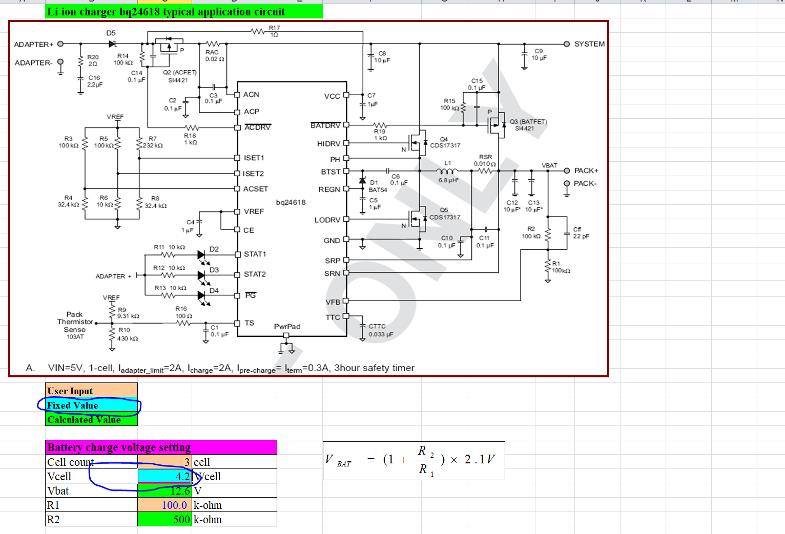

My customer Autel is using BQ24618 to charge 3-cell battery, each cell is 4.35V.
So they adjust the feedback resistor to 22.1K & 4.22K, which can set the VBAT charge up to 13.05V.
But the test result shows the charging will only arrive at 12.6V, which seems only accept 4.2V/Cell.
Charging current is about 4A.
Can you please double check if BQ24618 support cell voltage >4.2V?
I find BQ24600 which looks maybe support 4.35V, is it the right choice?

    From our design VFB = 4.22/(4.22+22.1) * 13.05 = 2.09V.
    From the caculation tools of ti web:
    VCELL for BQ24618 is not adjustable, but with fixed value. In BQ24600, it is able to change to 4.35V.
    This is why I'm confused about the VFB of BQ24618.
