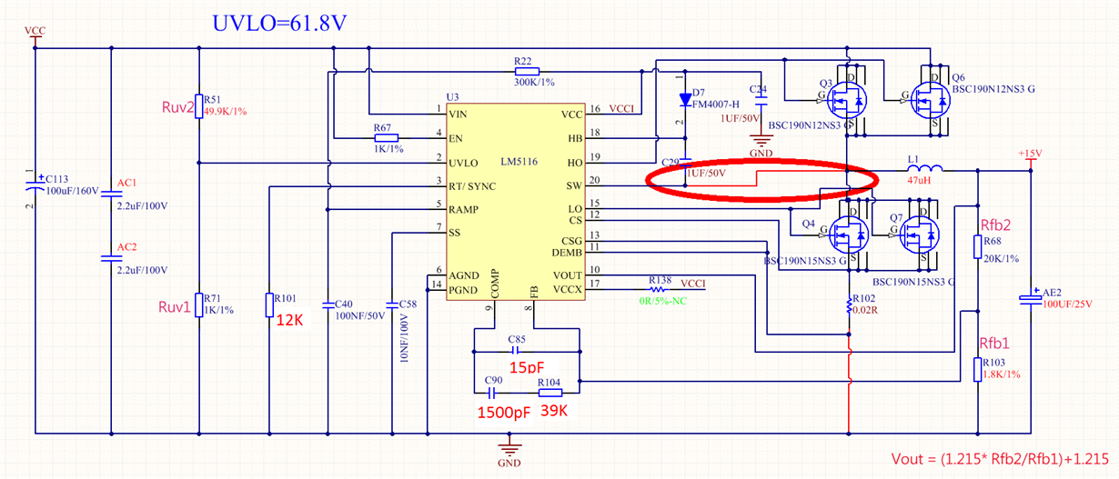

our client use LM5116, power spec and schematic as below, and we find IC have damage risk.
sysem power spec:
• Input Range: 72V to 100V
• Output Voltage: 12V
• Output Current: 2A
schematic:

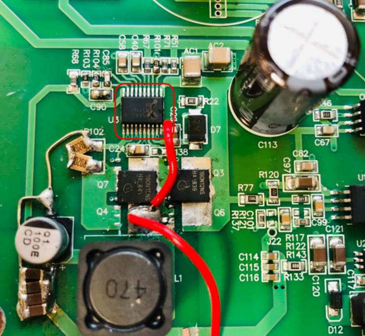

damage picture:
measurment pin to GND.
LM5116 Fail IC
Pass
Fail
PIN
to GND Ω
1
3.35M
x
2
3.93M
4M
3
4.16M
11
4
3.82M
3.86M
5
3M
3M
6
GND
GND
7
3.8M
3.8M
8
4M
4M
9
3.27M
3.3M
10
3.8M
3.9M
11
4.06M
4.12M
12
4.4M
4.47M
13
2.2
4.31
14
GND
GND
15
3.7M
4.53
16
27K
29
17
84K
62K
18
3.27M
12K
19
10M
15
20
4.7M
10

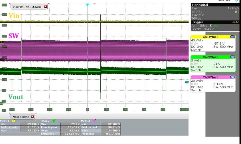

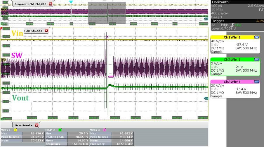

measurement waveform:
Also we use AN-1596 LM5116 Evaluation Board to change output voltage 15v, but we find IC Temp Tc was pretty high.
If any suggestion, Please advise me.

  • Hi Lawrence,
    Here are some comments:
    Do not exceed VCCX max operating voltage of 15V. If VOUT is 15V, use a series diode or low voltage zener to reduce the voltage.
    Input capacitors should be much closer to the FETs (this is to reduce power loop parasitic inductance and thus SW voltage overshoot).
    Use a 100nF boot cap (1/10th the value of the VCC cap).
    Use a 1uF decoupling cap from VCCX to GND.
    The boot diode seems large (a smaller footprint is adequate).
    No need for paralleled MOSFETs in a 2A application.
    Tim
