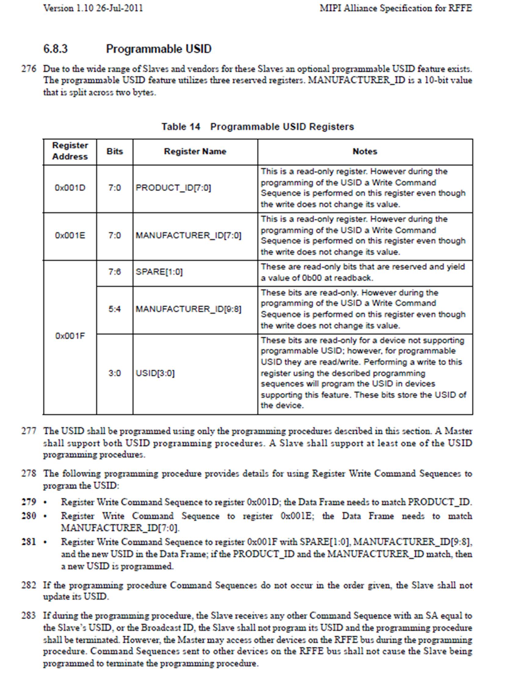

1. I understood like the Slave Address is programmable through RFFE interface. But I was not able to successfully change the slave address. I tried writing the value 0x16 to the register addr 0x1F. But the new value is not reflected. It will be helpful if I can get suggestions to programmatically update slave address (USID)

    1. You are correct that the USID should be able to be set via this register. I am having the same issue as you when setting this up on the bench though. This is the only way that I see documented to update the slave address.

    On #1, I understand that you are also observing an issue in changing slave address. Can you please help getting the procedure to change the slave address if it is possible? If not, could you confirm if this is an issue? Because the device behavior and the data sheet descriptions on Device Enumeration are conflicting. Correct me if I am missing something here.

    1. After looking further into it, the RFFE standard has some nuance to it in order to change the USID. The product and manufacturing IDs of the device need to be written to the product and manufacturing Id registers. Even though these are read only registers, the values that are in the register need to be repeated to these registers to allow altering of the USID. Refer to the image below for more information. This procedure will also need to be done every time the device is power cycled.
