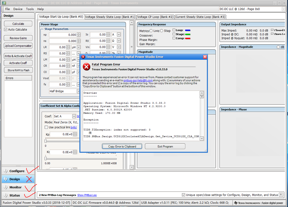

UCD3138: there is fault on Fusion Digital Power Designer
Part Number: UCD3138
Hi
i have asked customer to install a new version Fusion Digital Power Designer, but this fault still appears.
when customer click  "Design" button, the fault will appears, which is shown as below.
why?
thanks.
  • To Who will read this:
    There is a error log file about the problem above, I hope it can help to find the solution.Thanks!

  • Is this an EVM firmare or customer implementation?
  • Amie,Thanks for your reply!  It is a product on selling now.  Our engineer didn't use "Designer GUI" before,I just found "Fusion studio" have this designer GUI recently,so I tried to use it.
  • The Fusion Studio in design mode is meant for EVM firmware as it assumes certain PMBus commands and loop configuration based on the pmbus setup id command.  Usually has something live "VERSION | LLC001".  If the firmware has changed from the EVM firmware then the design mode may not be supported properly, which is why the problem has happened.
  • Oh,I see! Thank you! Then,if I want know more the use of the designer GUI, is there any detail instruction on the internet? Can you provide a link? Or anyway else? Thanks again.
  • You can take a look at the user guide () and see the design section. You can also use offline mode with a topology to see what is shown in the "Design" tab.
