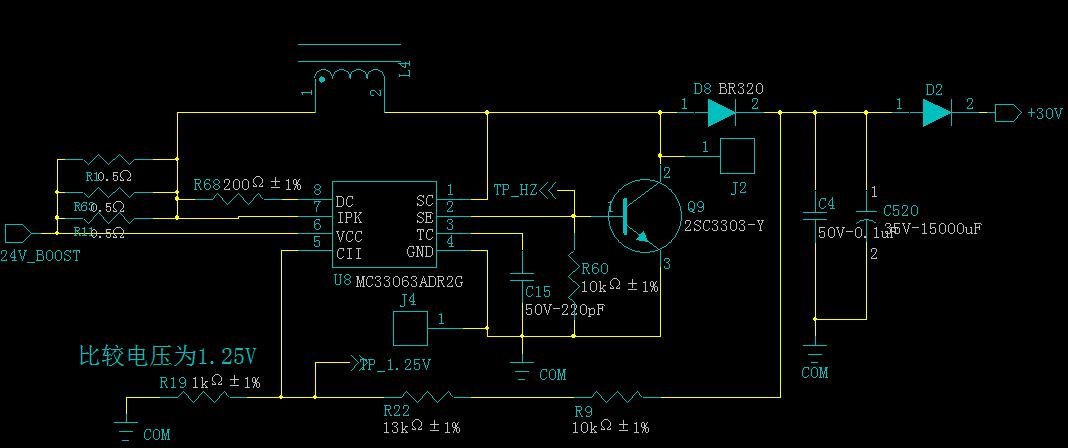

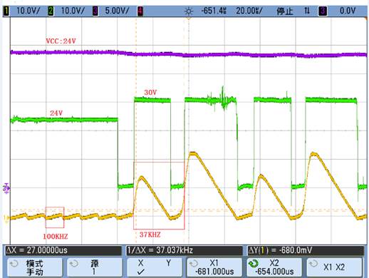

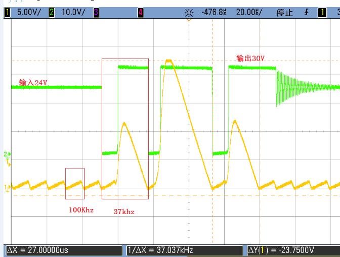

My customer met a issue when using MC33063A. Circuit is as below. Per check, seems no problem. But customer measure the voltage of Pin.3(CT) and found it behave strange high voltage(near 20V) when switching, as below waveform in yellow line. The circuit works normal and can output. Please help check the reason. Thanks.
