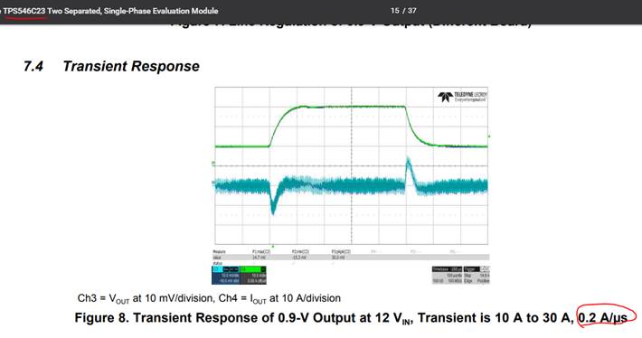

Hi team,
could you please share the 2.5A/us transient performance on the TPS546C23 evm? (10A~30A is ok). Thanks.
