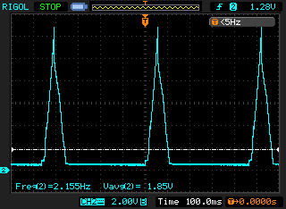

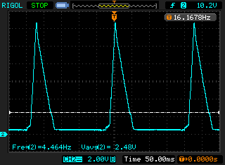

  • Tested with a load capacity of 5000uF, load current 1A. Input voltage 43Vdc.
    Removed the waveform of the output voltage and voltage on the C35.
    With two values C35:
    Basen 220nF
    Vout
    Voltage at C35
    and modified 820nF.
    Vout
    Voltage C35
    Vision:
    • With a baseline value of C35 220 nF. At current load 1A, SMPS cyclically restarts. If you increase the load current to 3-4A, SMPS normally starts.
    • At C35 820nF. SMPS cyclically restarts at any current load of 1-10A.
