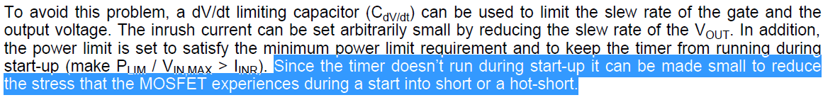

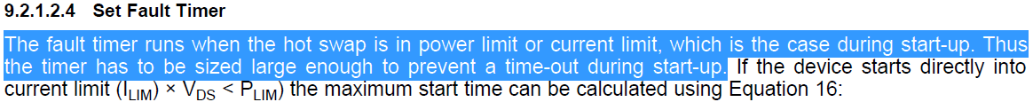

I want to mask the inrush current at the LM25066 start up timing.
1.When the power supply ON timing, Does the TIMER pin work?
   I want to mask the only in-rush current using the CTIMER.
 There are two kinds of explanations in the data sheet.
(1)
(2)
2.Please tell me other ways to mask the inrush current.

    By using dv/dt startup, the Cdv/dt is so selected that the inrush current is clamped to a value lower than set current limit and power limit there by not triggering either current limit or Power limit. But,this will increase the time taken for startup.

  • Hi Yusuke,
    The input voltage drops even more if there is no inrush current limit. this is because, if you do not limit the inrush current, the inrush current can be very high resulting in heavy drop of Vin based on source impedance.
    If you are very concerned about drop in Vin during startup and do not have much concern about startup time, the best way is to use dv/dt based startup.
