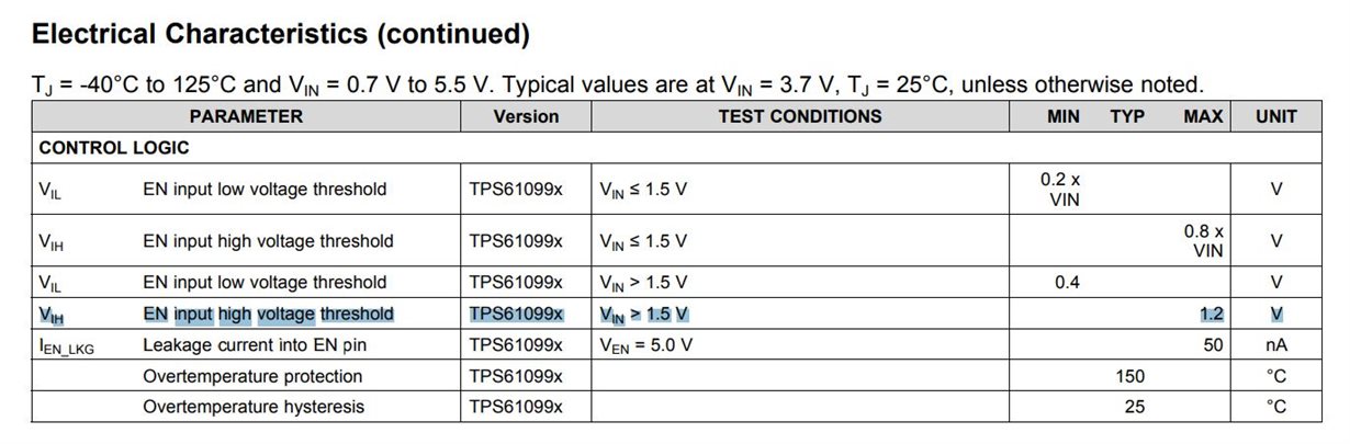

I want to provide control on enable pin of TPS61099 boost IC but i found in Data-sheet, its VIH level is 1.2V max when Vin is greater than 1.5V. In my case Vin is 4.2V. See attached image.
Please let me know is it correct data or not since i checked in typical application it is directly short with Vin.
And apart from that clear one more thing TPS61099 and TPS61099x both having same VIH level? Since in Data-sheet there is mentioned about TPS61099x only.
