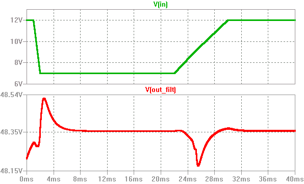

  • Hi Garrett,
    Thanks for the response. If I want to have some idea what kind of output transient I will see, do you think I'd be able to use a transient SPICE simulation?
    It would be better if I could get a good ballpark of what the transient response on the output due to a sudden drop in the input before I try and produce this thing. It might be weeks, and a lot of work, before I could get a physical prototype together.
    Steve H
  • Hi Garrett,
    I don't know how much this is worth, but I did manage to throw together a SPICE simulation of the demo board that is getting hit by input transients. As you can see, the output moves around by less than 1% which is pretty good. I don't know how closely this tracks with physical reality, but it's at least encouraging.
