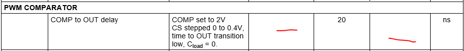

LM5021: lead edge blanking time and COMP to OUT delay
Part Number: LM5021
Hi TEXAS team,
Customer want to know the Min and Max value of lead edge blanking time and COMP to OUT delay.
There is only typ. value in the datasheet. Please help to provide the Min. and Max.
Thank you
Yingzhe Xi
leading edge blanking time
  • Hello Yingzhe,
    Thank you for your interest in the LM5021 device. To answer your question, I'll need to contact the factory to find someone who can provide the numbers. I'm not sure how long it will take to respond; maybe a day or two.
    I'll submit the query.
    Ulrich
  • Hello Yingzhe,
    I'm sorry for the long delay in my reply. I've tried several times to get an answer from the factory for these parameters, but I'm unable to obtain the information for you.
    It is unlikely that they are trimmed parameters, so a conservative estimate can be to assume +/-30% variation around the typical values.
