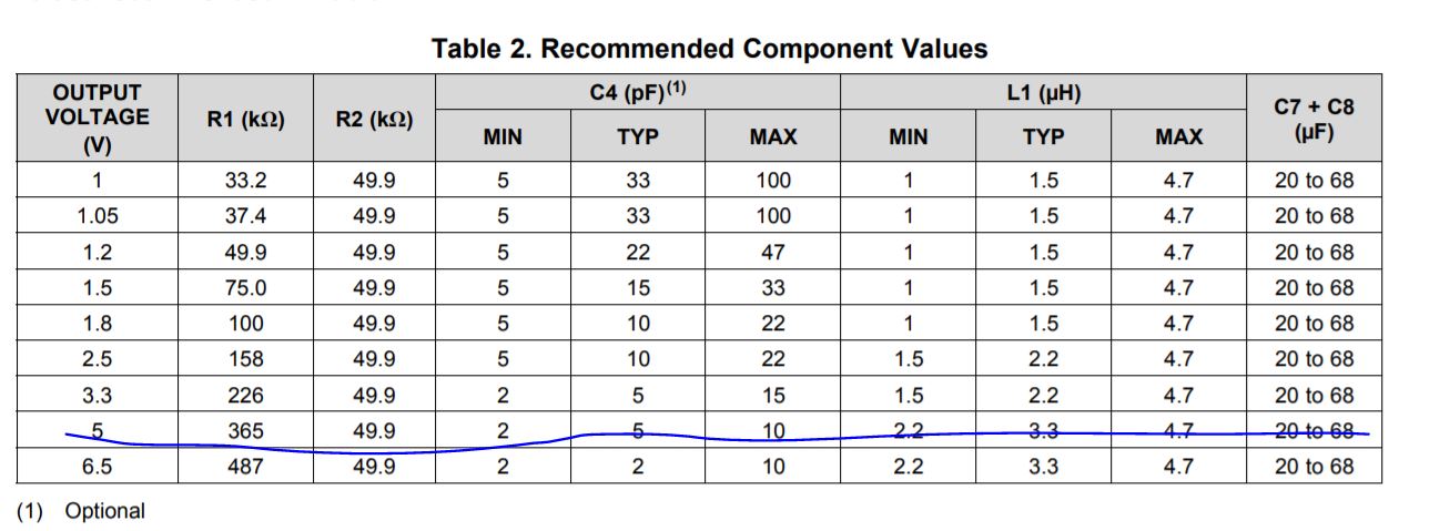

Is there measured data for frequency response (bode plot) of TPS56528?
※Condition is Vin:12V, Vout: 5V, Iout: 5A
Or, is this data nearly and reference below application note, Figure 20?
Satoshi
Satoshi
