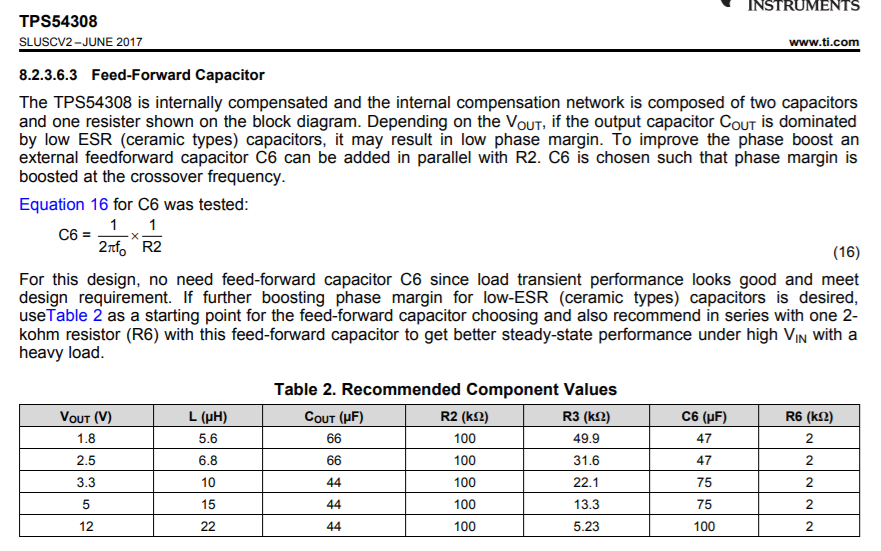

Hey guys,
My customer found a typo in the datasheet. There is a table on page 18 that helps with choosing passive components, and it lists the units for the C6 feed forward cap as "uF" when it should be pF, like shown on page 12.
Brian
