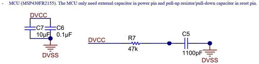

3. what is the function for following circuit?
    [Penny]It is better to consult with MSP430 team on this.
