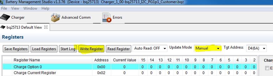

Could you tell me about Battery Management studio GUI for bq25713.
I set bq25713 register using Battery Management studio and made the data into a text file.
However, I loading text data was not reflected.
As an example, I will attach a screen shot of setting the charge current resister.
bq25713.pdf
Please tell me the reason and solution.
If this problem is not resolved,
I have to enter the setting every time.
Could you give me your support.

  • Hey Tsukui-san,
    Please confirm that when you select "Load Registers", you are also in "Update Mode: Manual" as seen below:
    You will then have to manually select "Write Register" for each register for which you have loaded settings.
    Joel H
  • Joel-san,
    Thank you for your kind support.
    I tried the method you indicated.
    I was able to load and write 0x06,0x08,0x3A successfully.
