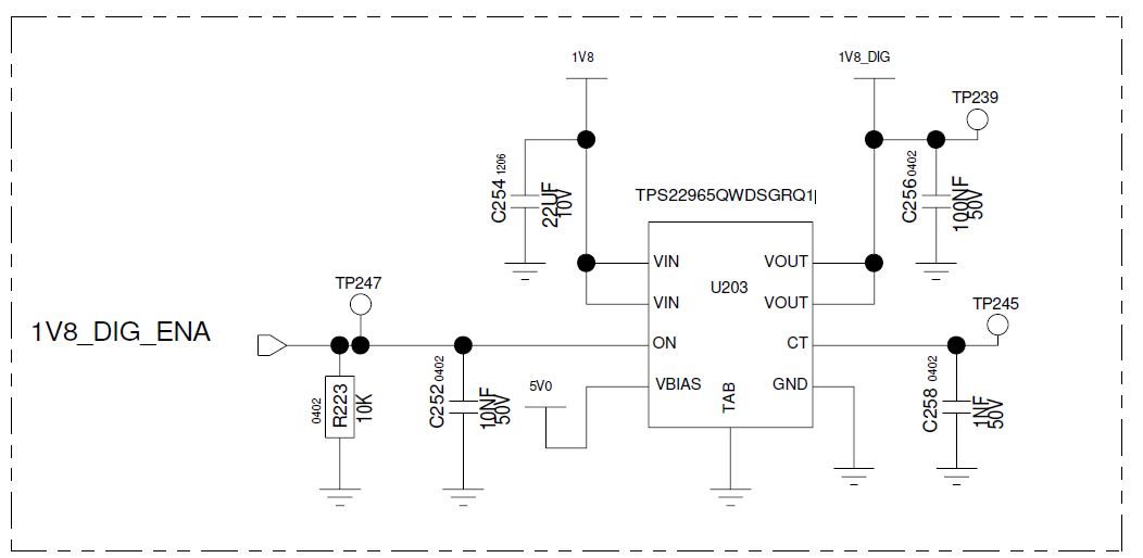

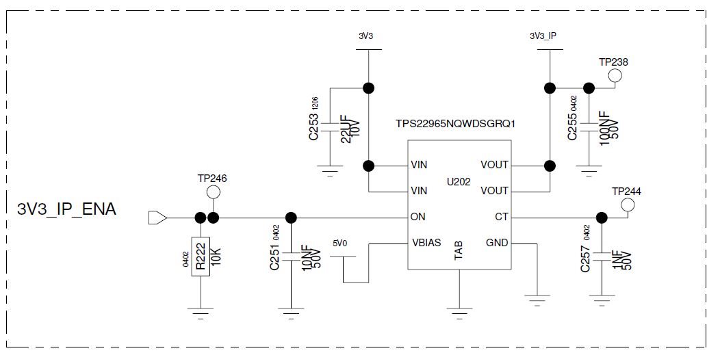

We are using two load switches TPS22965NQWDSGRQ1(U202) and TPS22965QWDSGRQ1 (U203) in our design.
Please refer the attached images (Sch1 and Sch2) for design reference.
Design Details :
Parameters U202 U203
Input Voltage 3.3V 1.8V
Bias Voltage 5V 5V
Enable signal  Controlled by uC (3.3V LVCMOS level) Controlled by uC (3.3V LVCMOS level)

    At an initial glance, I don't see anything wrong with the schematic.

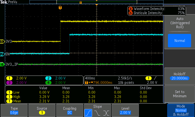

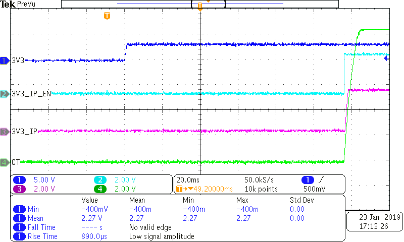

    2. Can you share any oscilloscope shots?
    Response :
    U202 - Working Condition
    U202 - Non Working Condition

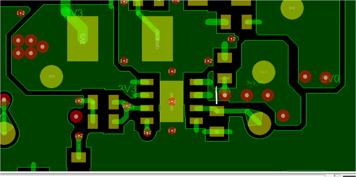

    6. What is your thermal pad connected to, GND?
    Response :
    Yes. Thermal pad is connected with GND only.
    (Please refer the below mentioned layout snap for reference. The line marked in white color is the place where the load is disconnected to verify the functionality of switch without load).

    Thanks for the detailed response! To clarify, the 1V8 load switch (U203) works properly, but the 3V3 LS (U202) does not? Looking at the schematic and the additional information you provided, I don't see any differences between 1V8 and 3V3 except the input voltage. Is that correct?
    Please let me know if you're able to replace the damaged TPS22965. I don't see anything incorrect with U203 from an applications standpoint, so I'm thinking the part might have been damaged during soldering or a potential short.

    For your note, 1V8 load switch also not working and exhibits the same behavior. As you said, except Input and output voltage there is no change in the connections of both load switches.
