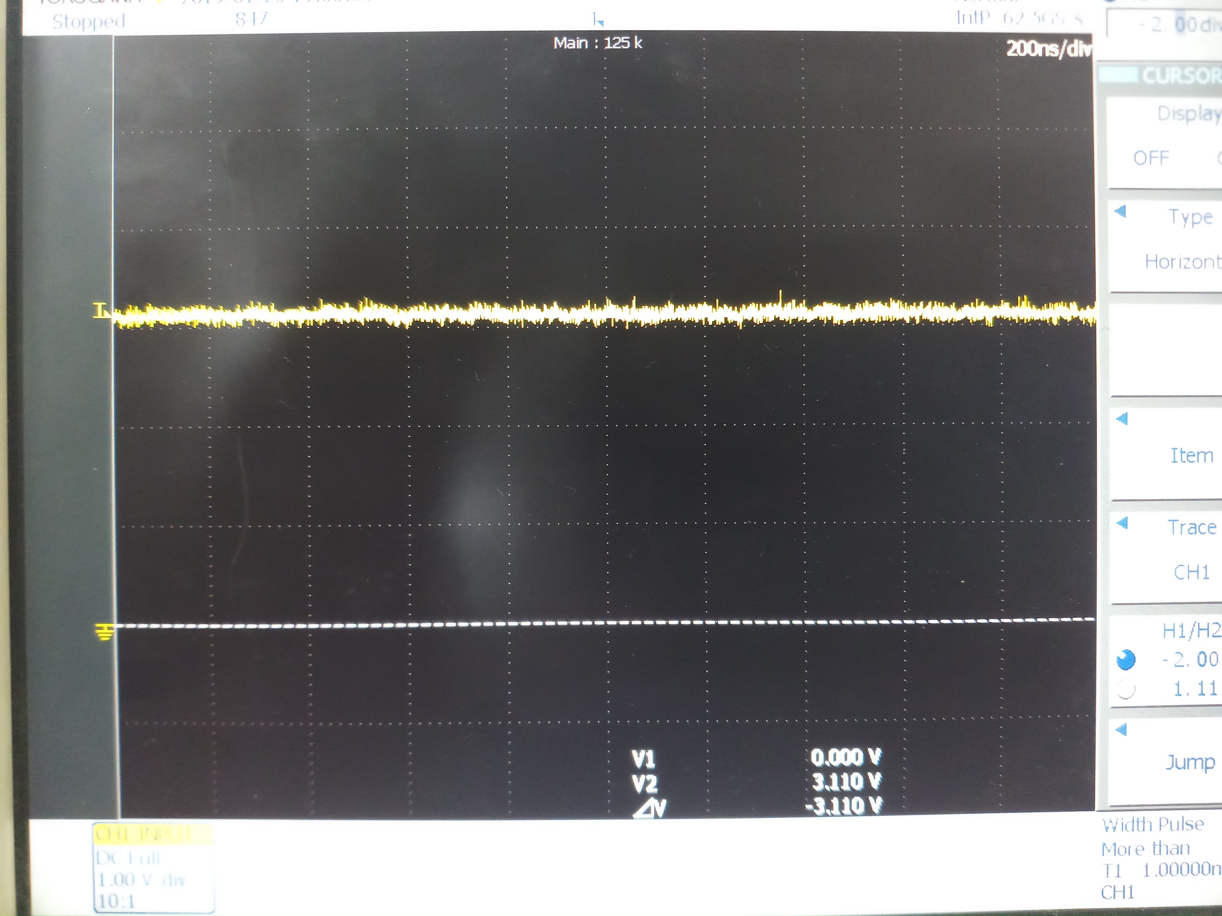

Here the layout is not a concern as i have the EVB board as well with me. The same IC with EVB board gets damaged. As the output voltage gets short with the ground.

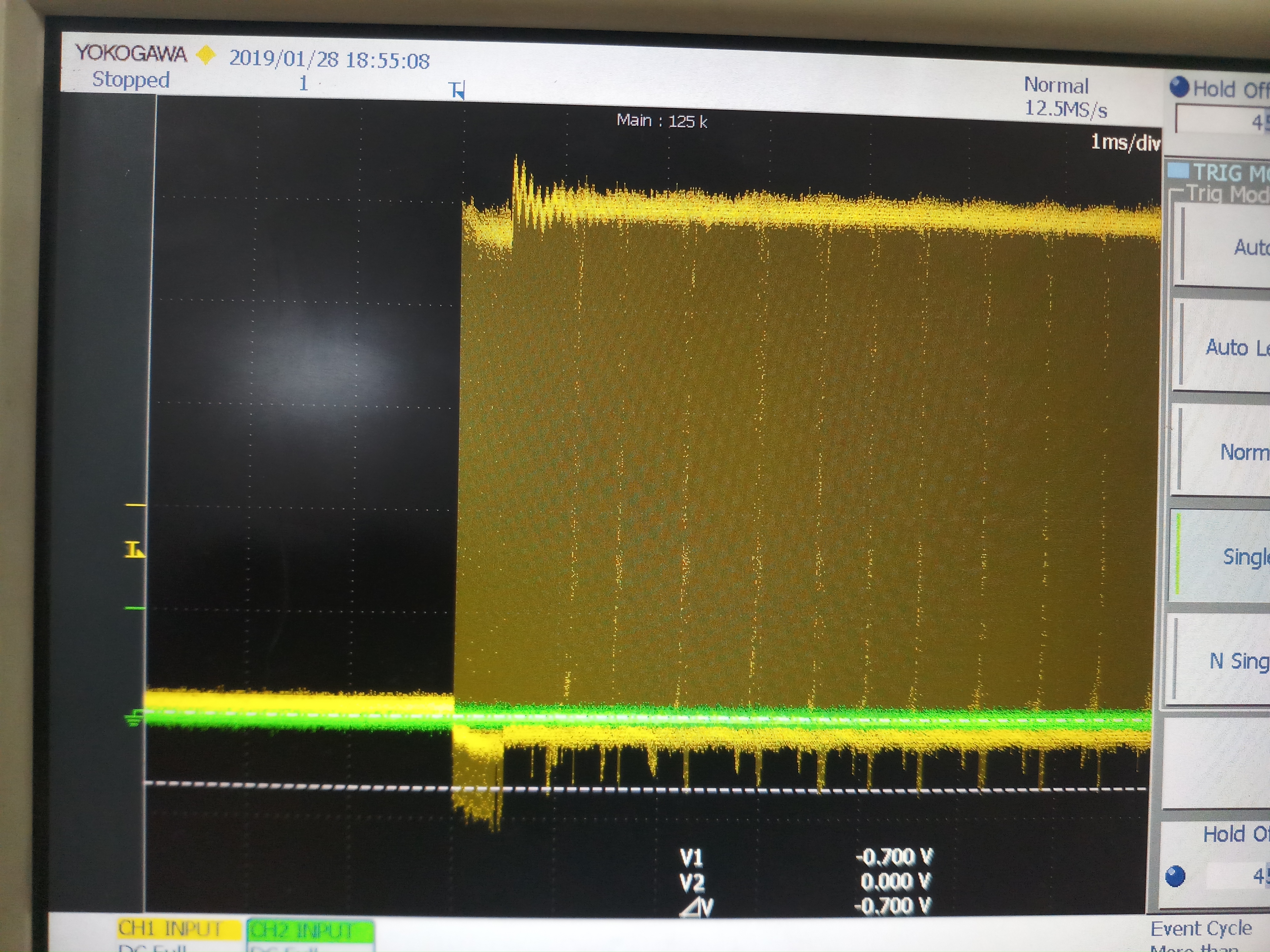

Here we are facing the issue from the field for the IC getting shorted to Ground. On analysis it was found that during power on the IC switching waveform of goes below 0V. Can this be the reason for the IC failure. As this is observed in the 5V to 3.3V generation.
Also it was found that the if the inductor is shorted the IC gets damaged. This was the case when Vin=5V and Vout=3.3V(Iout = 300mA). This was repeated 5 times. Every time the IC was shorted.

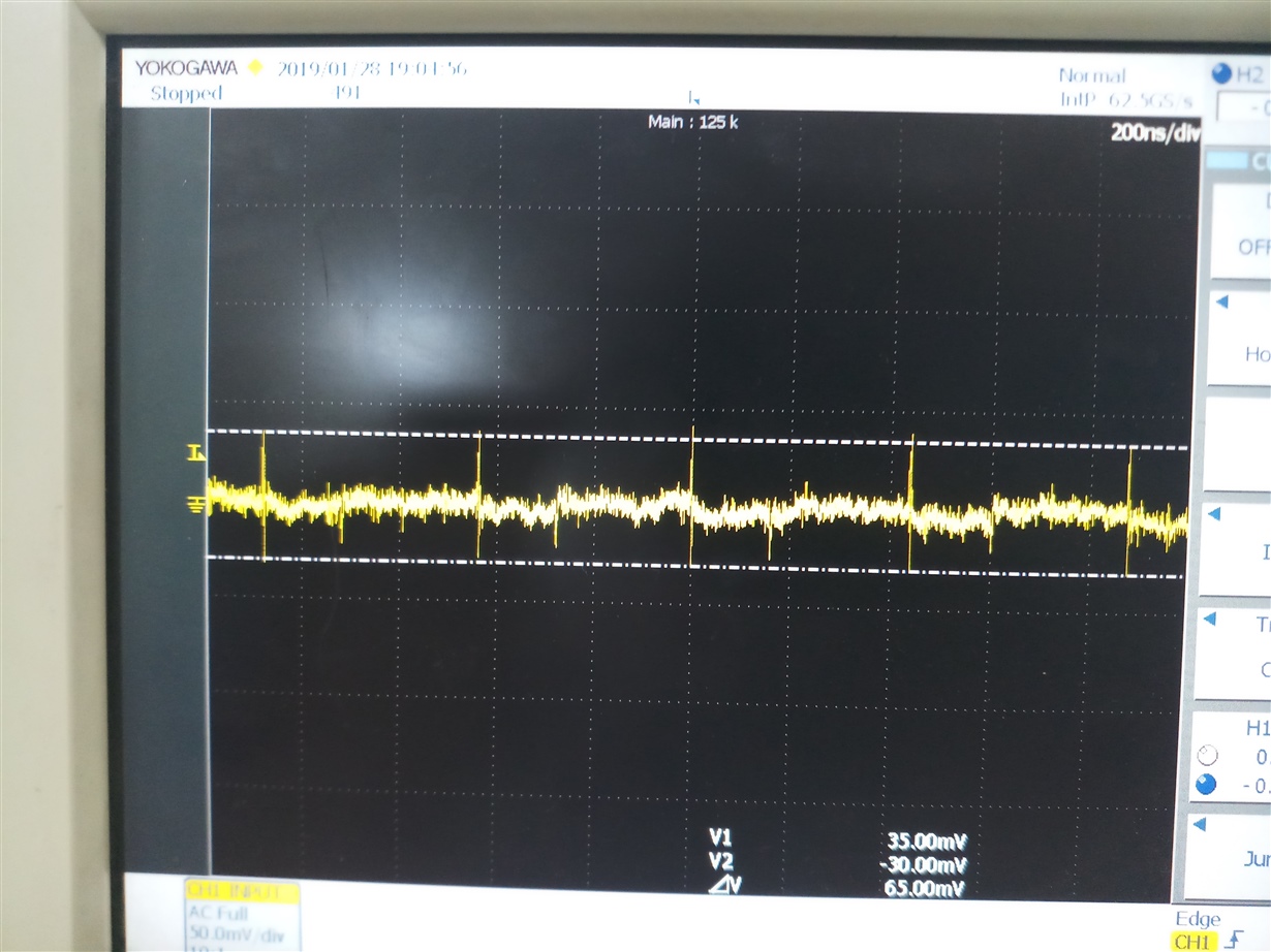

    --> Scope plots for SW node during startup with EN pin connected to VCC (image1), Switching node waveform with Capacitor(1UF) across R126(asperabove design) on EN Pin in order to add soft start on the input voltage(Image2), Output Voltage in DC coupling mode (Image3), Output Voltage in AC Coupling mode(Image4). While measuring the care is taken that the ground tip is connected directly with the CRO probe. While the measuring tip is connected directly to the SW node/output capacitor as per the measurement taken.

    6.) It is normal that the switching node became negative because it is due to the conduction of the body diode (in synchronous configuration).
    If you intentionally test your board or our EVM shorting the inductor, this is a not recommended action.
    The rating is specified in section 7.1 of the datasheet (page 4).
    --> Regarding the negative spike it is clear and we have gone through the document SLVA494A.
    --> Fine it not recommended action, This was intentionally done to create the failure, but on further observation and analysis it was found that the part gets fail. Other than that even if you probe the CRO pin on the SW node it also damages the IC. While, if the Input voltage is reduced to the 3.3V and the output inductor is reduce to zero. The IC goes under shutdown mode and gain recovers back. The damage occurs only in with 5V input and 3.3V output.
