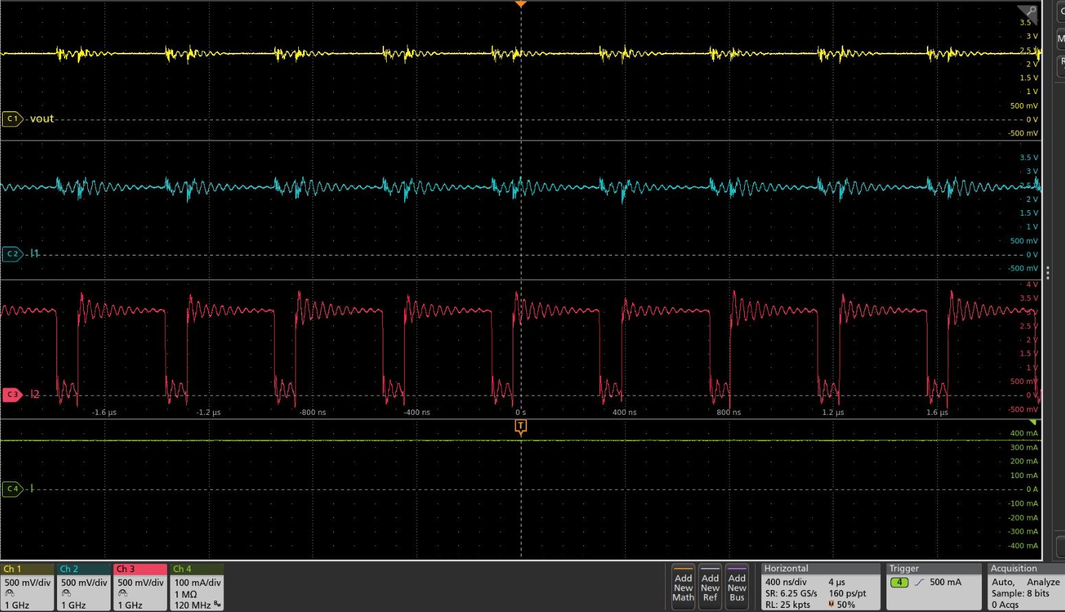

Datasheet says it's driver works with power 5.5 - 3.1 V.

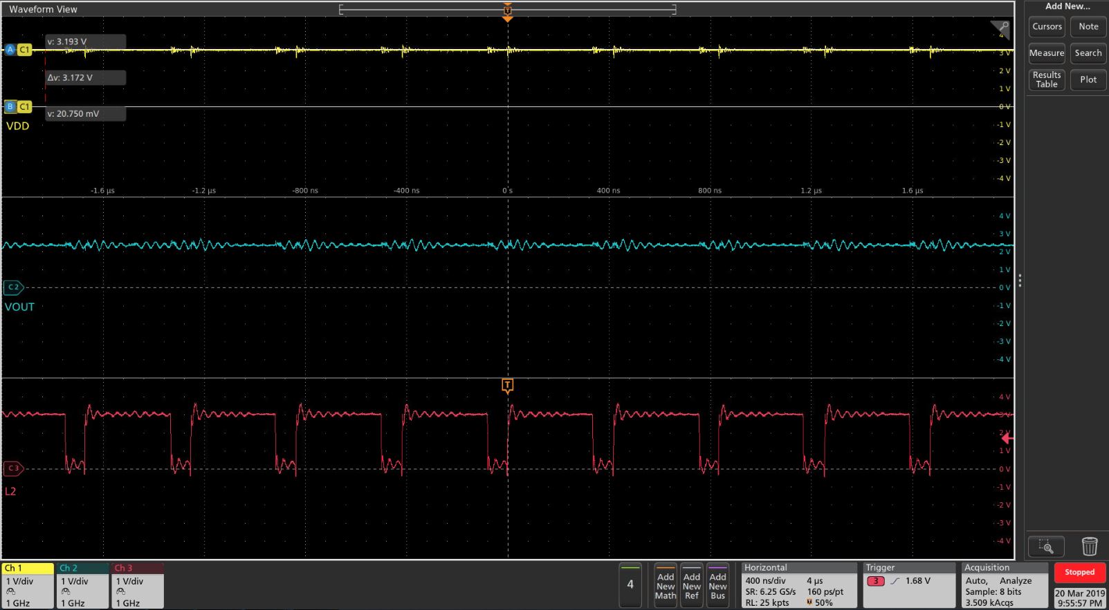

Driver starts to work unstable and don't gives 350mA current (~120 mA extremely unstable current) when i take a battery as powersourse and voltage falls to 3.65.
Where i was wrong?

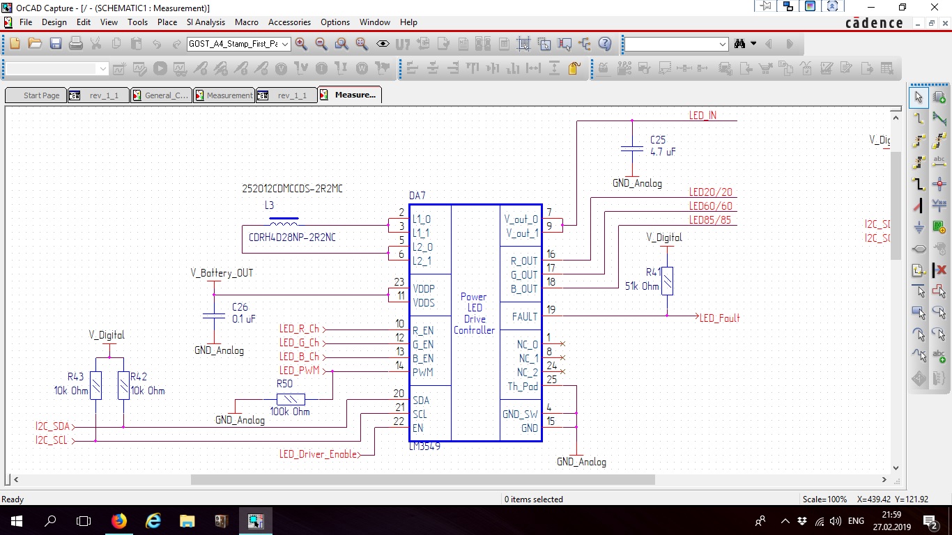

The power scheme was typical, as in the specification.
