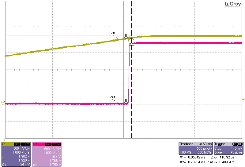

Could you provide the response time to output Vout(typ)*0.98 after VIn reached to 1.9V(typ) UVLO? We would like to know the time between UVLO=1.9V and output of Vout(typ)*0.98.

    A typical startup for the TLV700 is shown below. The startup time once the input voltage passes the UVLO threshold is about 120 us.
    Test conditions were as follows:
    Test Board: TLV700xxEVM-503
    User's Guide: http://www.ti.com/lit/ug/sluu391/sluu391.pdf
    Vin = 1.95 V
    Ven shorted to Vin
    Vout = 1.8 V
    Iout = 0 mA
    Cin = Cout = 1 uF
