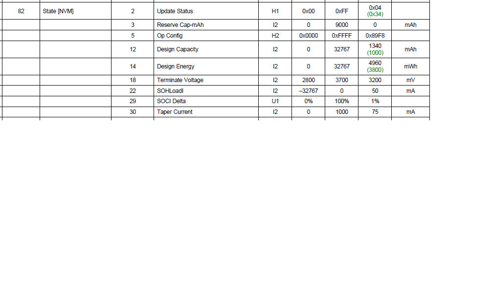

I encountered a miss match between data sheet and actual data block structure.
In the data sheet data block subclass 82 shows like this:

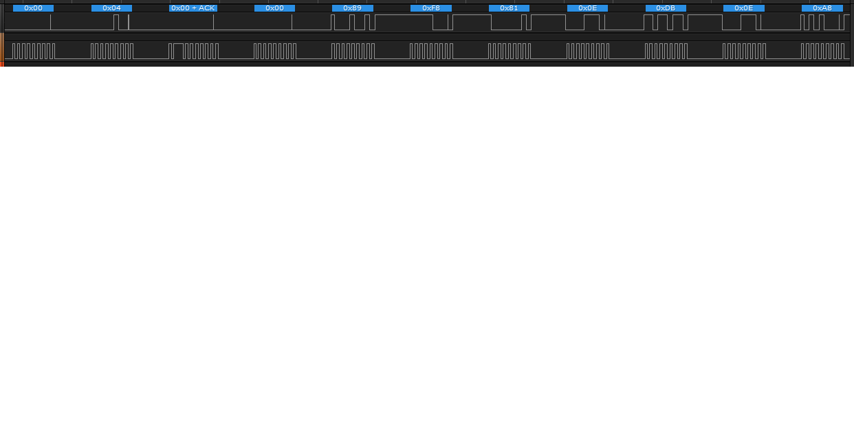

Actual reading from device looks like this:
It seems that there is a bias of 1 byte in offsets.
Update status (0x04) should be at offset #2 but actually is located at offset # 1.
Any ideas?
