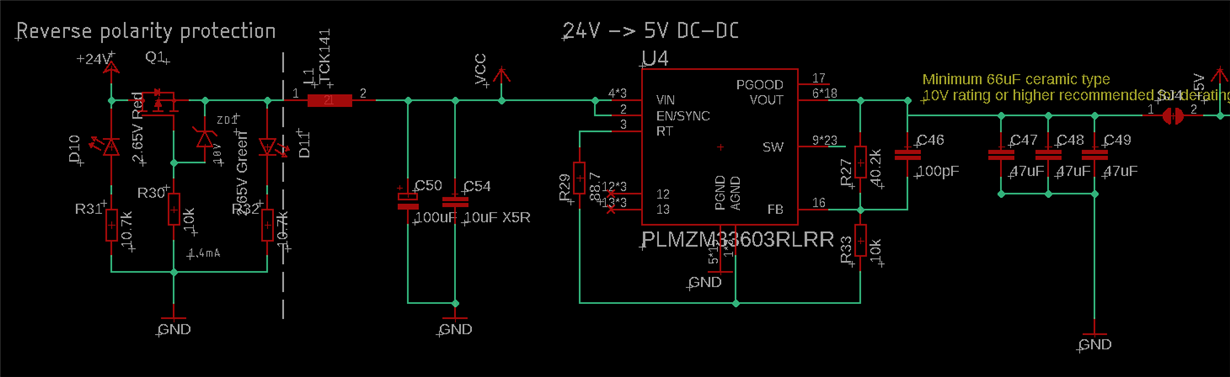

I've attached the schematic used. The chip that is being used is the 2A version, not the 3A like the schematic suggests.

    The schematic that you've provided follows the typical application schematic found in Section 8.2 of the datasheet. What is the maximum ambient temperature you have your system in? How large is your copper area?For a 24Vin -> 5Vout @ 2A application the expected power dissipation is roughly 1.3W. You can use this information and your expected maximum ambient temperature and plug it into the thermal resistance equation found in Section 10.3 to see whether you are within the recommended copper area.

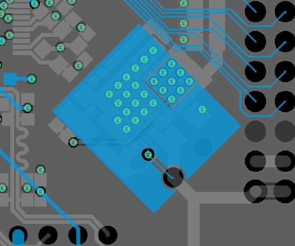

    The ambient temperature is room temperature(20-25). If I touch the underside of the PCB which is shown in the picture, it's almost painful to the touch. This small GND plane is connected to the internal ground plane that covers the whole board(4 layer PCB) with the via's. The output of this chip is NOT connected to the power plane of the PCB(different voltage). This heat seems excessive while the whole system is only using 2W(what the bench PSU shows, so input power). On the left is the chip that is using most of that power, which is also connected to the ground plane in the same manner.

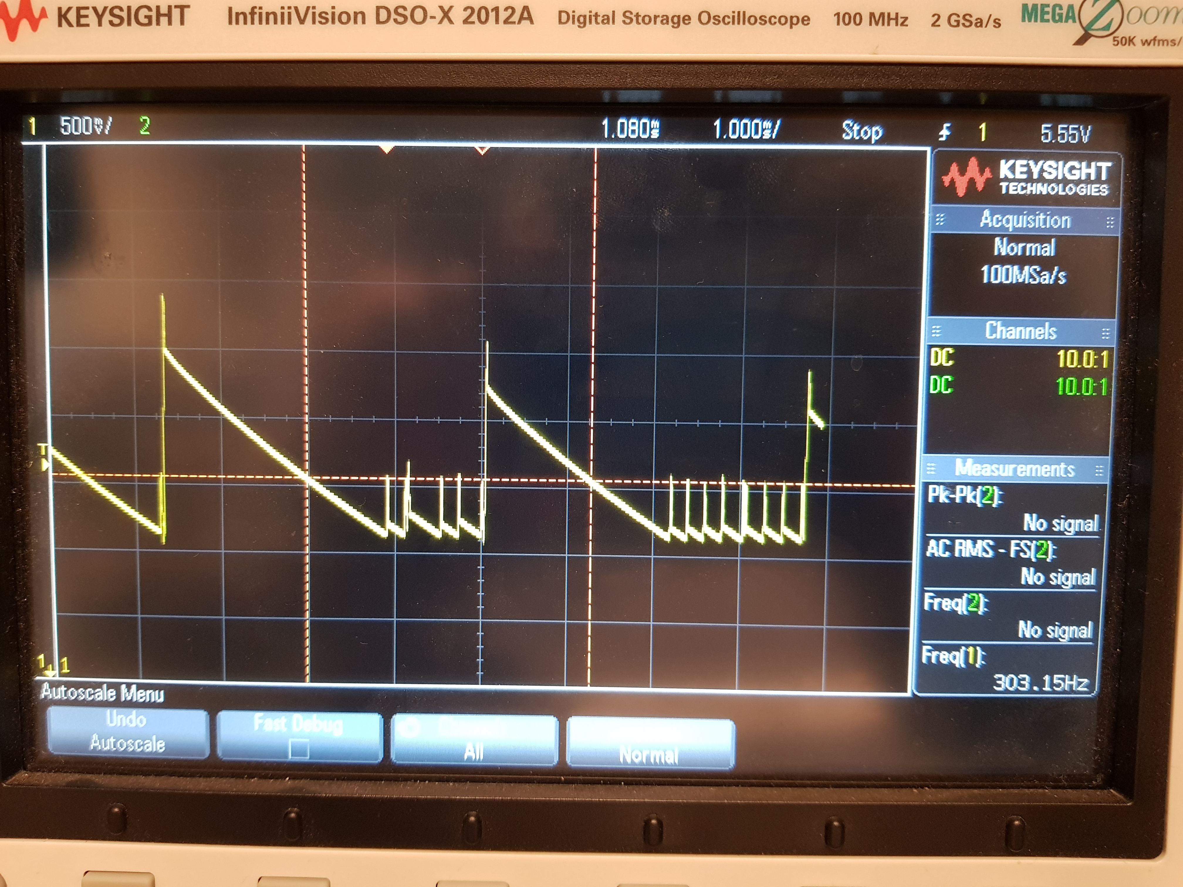

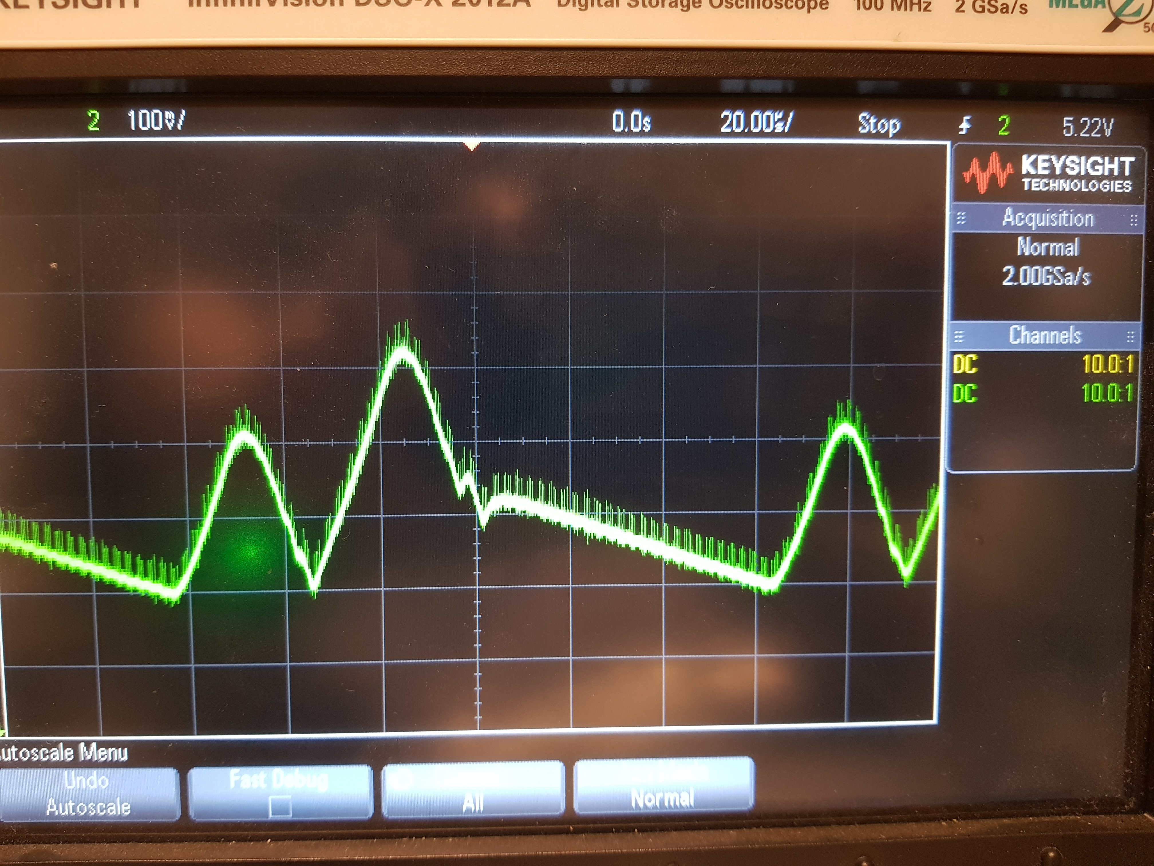

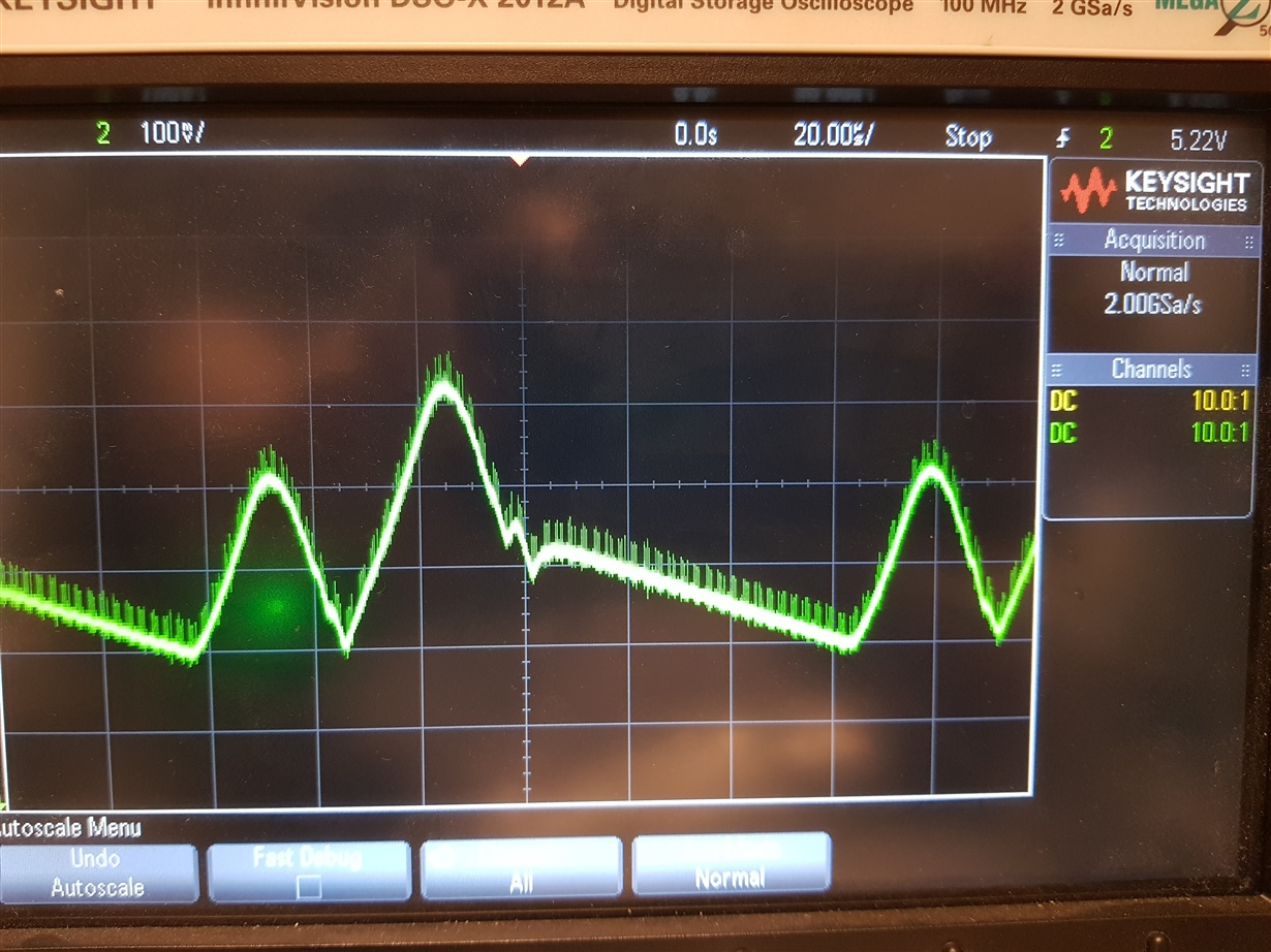

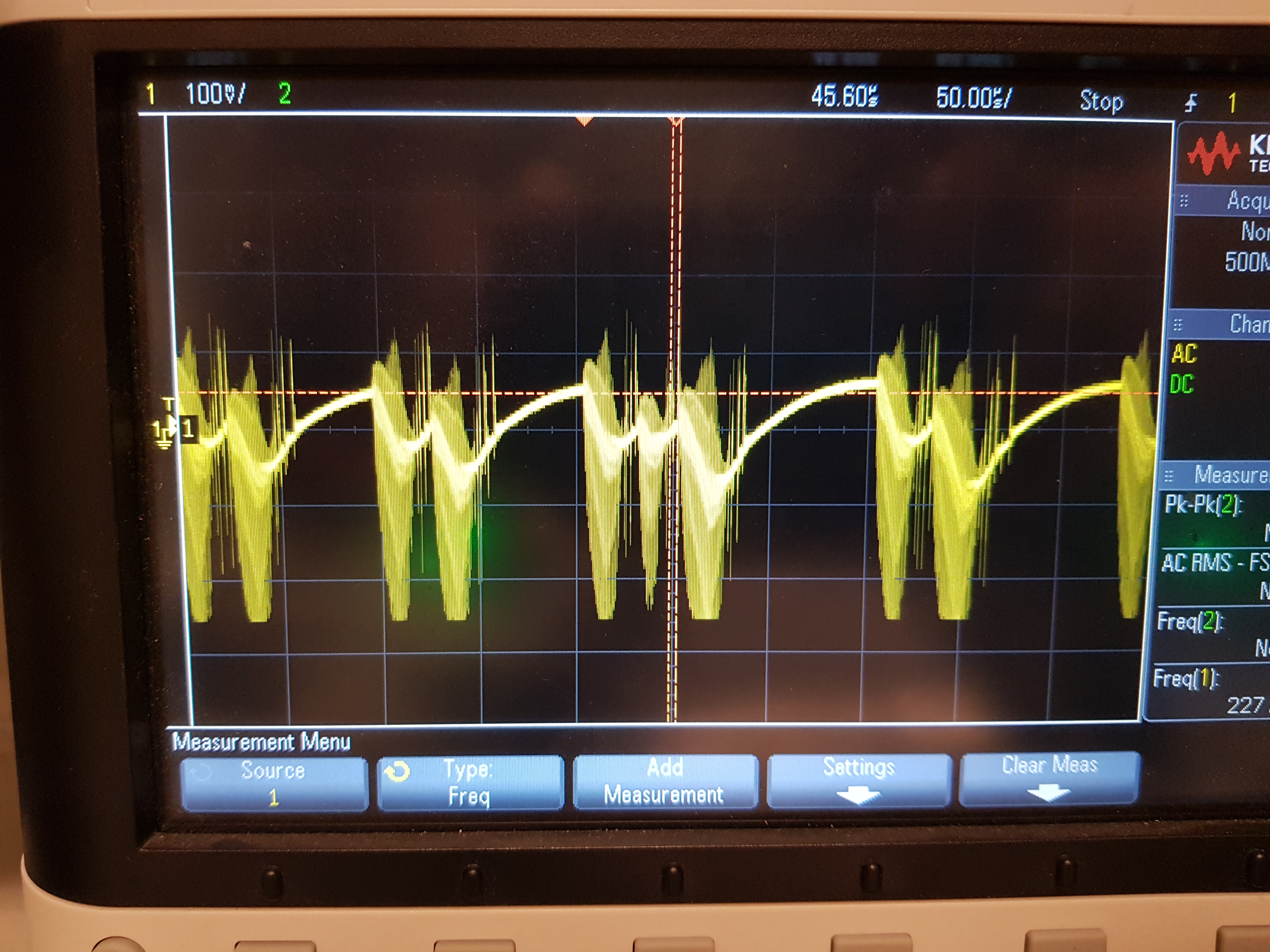

  • Top one is the output on a only a 330ohm resistor for reference. You can see that it shoots upwards to 5.9V, which is nowhere near the specs given in the datasheet. Other photos are with other IC's behind it, including another DC-DC converter.

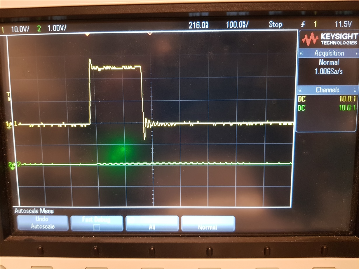

    Second one is the output of the SW pins.
    Third one is the input.
    Last one is the output when everything is hooked up normally. It's fed by a bench power supply with it's own noise.
    There are audible noises coming from the chip as well. The electrolytic capacitor is fresh out of the box.

    What are you powering on the output of the LMZM33602 device? What did you meant by "The output of this chip is NOT connected to the power plane of the PCB(different voltage)". What is the output of the LMZM33602 connected to? The datasheet recommends using large copper area for power planes (VIN,VOUT, and PGND) to minimize conduction loss and thermal stress. Can you show me the VOUT copper plane from your PCB snippets?

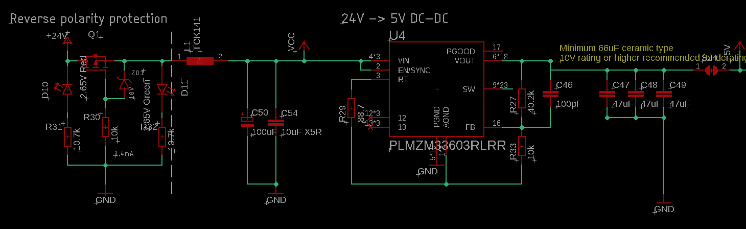

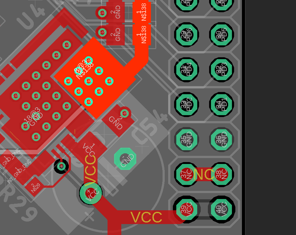

  • This is the full circuit that exhinibits this behavior. The output is disconnected from the rest of the circuitry. The L1 inductor(noise filter) has been removed and simply bridged, which improved the performance but didn't fix it.
    I'm currently not able to test a new one of this chip because of practical reasons. There is currently only 1 board and simply removing the chip is not possible because of the significant thermal plane.
    VIN is not connected to a thermal plane and VOUT only has a small plane on the bottom roughly the same size as you can see in this layer connected with 9 via's. It gets extremely hot to the touch.
    If thermal planes on VIN and VOUT are required that's a problem for this board.
  • Hi Frank,
    It is primarily important to have multiple thermal vias from PGND pin to a power ground plane for good thermal performance. Having large copper areas on VIN and VOUT will definitely help with thermal stress. What is also important is the PCB copper area of the circuit. Let's assume worse case scenario of 24V to 5V conversion at 2A current loading. At the ambient temperature that you have (20C - 25C) the recommended ThetaJA = (125 - 25) / 1.3W = 77C/W. Looking at Figure 42, you may be able to achieve that at 10cm^2 which turns out to be 30mm x 30mm copper area.
    Since you said that the small GND plane is connected to the internal ground plane that covers the whole board this sounds sufficient for thermal dissipation. You state that you noticed a high-pitch whining coming off the board at the dc-dc converter. Perhaps the internal inductor has EOS damage which would affect the inductance of the inductor result in a lowered maximum loading capabilities of this device. If the inductance is somehow compromised then it could be running hotter than expected. How well regulated is the input voltage into the LMZM33602? Does it ever spike above absolute maximum?
