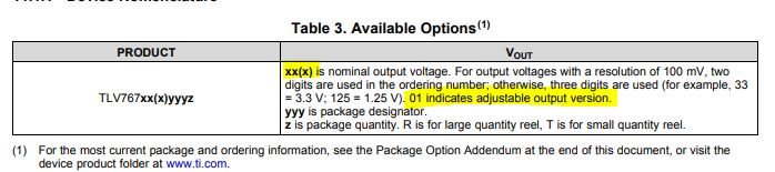

I'm very interested in TLV767 to use it as a 5V input, 3.3V output regulator. In the datasheet a fixed output version is mentioned for pinout and characteristics but there is no references for this version and it don'ts seems available yet.
And references : TLV76701DRVR and TLV76701DRVT are not specified with fixed nor adjustable output. I suppose those references are only for adjustable output ?
Can you tell me when fixed output are scheduled to be released ?

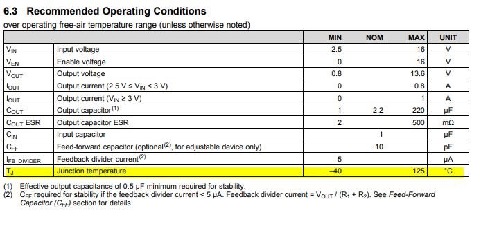

PS: For my application  a 180°C thermal shutdown is very nice ! It's not easy to  LDO that don't turn off close to 150°C in this package.

  • Hi Julien,
    We currently only have the adjustable version of the TLV767 family released; however, we are planning to release fixed output versions this year.  We do not provide detailed scheduling on the forums.
    In order to help customers decrypt our orderable part numbers, we include a Device Nomenclature table in our datasheets.  The 01 in TLV76701 indicates an adjustable output.
    I am glad that you are excited about this device; however, it is important to keep in mind that TLV767 is designed, characterized, and tested for an intended operating junction temperature range of -40 to 125 C.  For junction temperatures above 125 C, the performance may or may not be as depicted in the datasheet.
