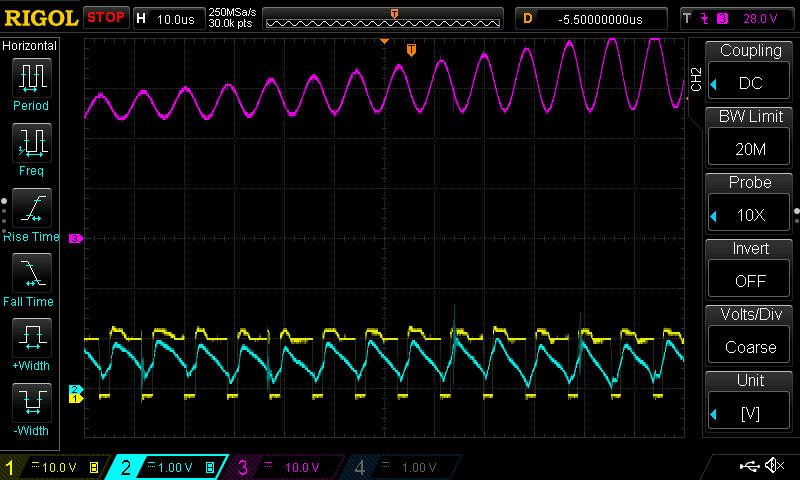

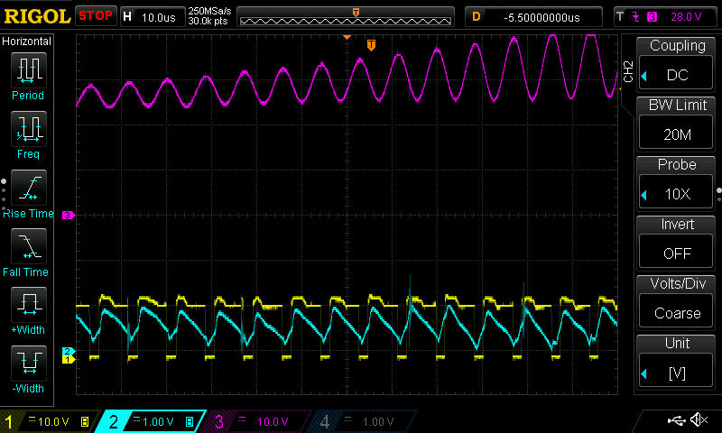

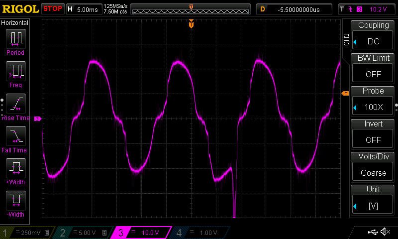

I am approaching 80% load in my testing and modifications.  I am now seeing what initially looked like an intermittent current spike on the AC input current.
I was able to trigger on this while monitoring the CSA and GDA, just before the FETs blew, again.
The current is actually going into destructive resonance.  The current signal is quite strange, almost like it has inverted.
My duty cycle limit is approximately 95%.
Can anyone interpret what has happened here?  I'm not sure where to start.
Tony
Current spike, Channel 3- Mains Current:
Smaller time scale. Channel 1- GDA, Channel 2- CSA, Channel 3- Mains Current:
  • Hi Tony,
    It may be that the current transformer is saturating.
    Around the zero crossings the duty cycle is maximum and the current transformer has a short time to reset.
    You should look at the output of the CT's and check what happens when the current spike occurs.
    If the CT is saturating you should re evaluate your reset and/or lower your Dmax value.
    Did you use the Excel calculator for your design ?
    John
  • Hi John,
    The blue trace above is the CT output.  I think it is already past the point of no return.  Can you point me to any examples of good/bad CT reset behavior before total loss of current sensing?
    Yes, we used the excel calculator.  I am examining the reset circuit, one of my colleagues put it together, it uses the diode/zener combination from PM4259.  I may change it to the basic R C for simplicity.
    Tony
  • Hi Tony,
    I dont have any scope pictures for what you ask.
    Your CT needs to be a high frequency type with adequate Volts.Secs rating forr your application and you need to ensure that the CT can adequately reset during the max on time of the FET. Those are the main requirements for this part.
    John
