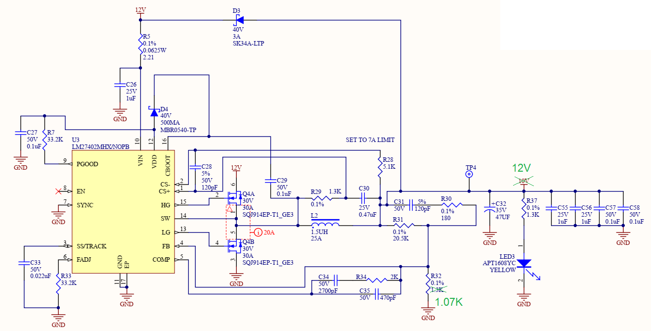

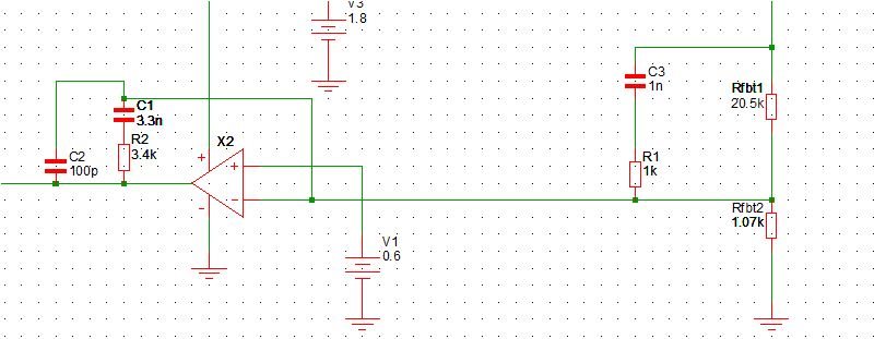

LM27402: Not starting up consistently with Vout=12V (original design was Vout=10V)
Part Number: LM27402
The enclosed design does not start-up consistently.   To change Vout from 10V to 12V, I changed R32 from 1.3K to 1.07K.  When it works, Vout=12V, it just doesn't come up consistently.  Do I need to change any of the other component values so it will work consistently ?  Thanks !
