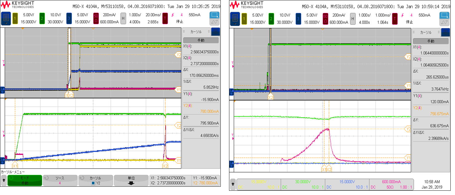

Please let me confirm about my understand is correct or not for PoE standard.
Information of PoE standard is attached below, is this mean ① and ② correct?
①Over current
 When overload current (Icut) continue to flow on the time of Overload time limit (Tcut, 50ms~75ms), PSE will be off the power source.
②Short condition
   When short current (Ilim) continue to flow on the time of Short circuit time limit (Tlim, 10ms~ at Type-2), PSE will be off the power source.
Customer is evaluating TPS23751 based on PMP11254 and below condition (No load).
 ・Connect LAN to PSE ⇒ After PSE sequence, supply PSE to VDD(52V) ⇒ VDD supply to VC ⇒ When TPS23751 startup, inlush  is occur
Customer want to confirm below inlush is keep the rule of PoE standard or not.

  • HI Satoshi,
    For 1 & 2, you are correct. These are the time limits for when the PSE needs to respond to a short circuit or overcurrent event.
    TPS23751 inrush complies with the PoE standard by limiting the current to 140mA, well below the 13W limit during inrush & compatible with all compliant PSEs. Additionally, it will stay in inrush for 80ms to make sure the inrush time duration more than satisifies the 75ms mentioned in the standard.
