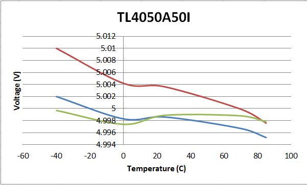

TL4050A: Reference Graph for deltaVZ
Part Number: TL4050A
Dear, Sir.

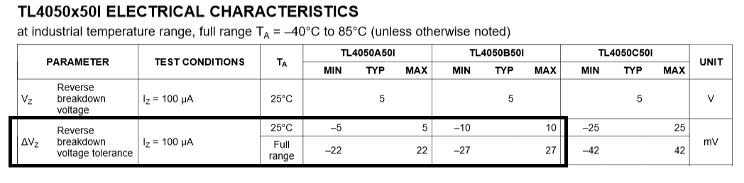

My customer is considering to apply TL4050A50I or TL4050B50I for therr system.
The temprature range will be -5 deg.C to 70 deg.C.
The deltaVZ parameter under full-range is defined on the dtasheet. The range will be
-40 to 85 deg.C.
They are expecting the accuracy improvement under narrow temprature range.
Is it possible to provide the reference graph for deltaVZ temprature coefficemcy on
several samples?  It will be so helpful for them.
You don't need to assure the spec even if you provided it, it is just for reference.
I am hoping to get your understanding & help at this time.
