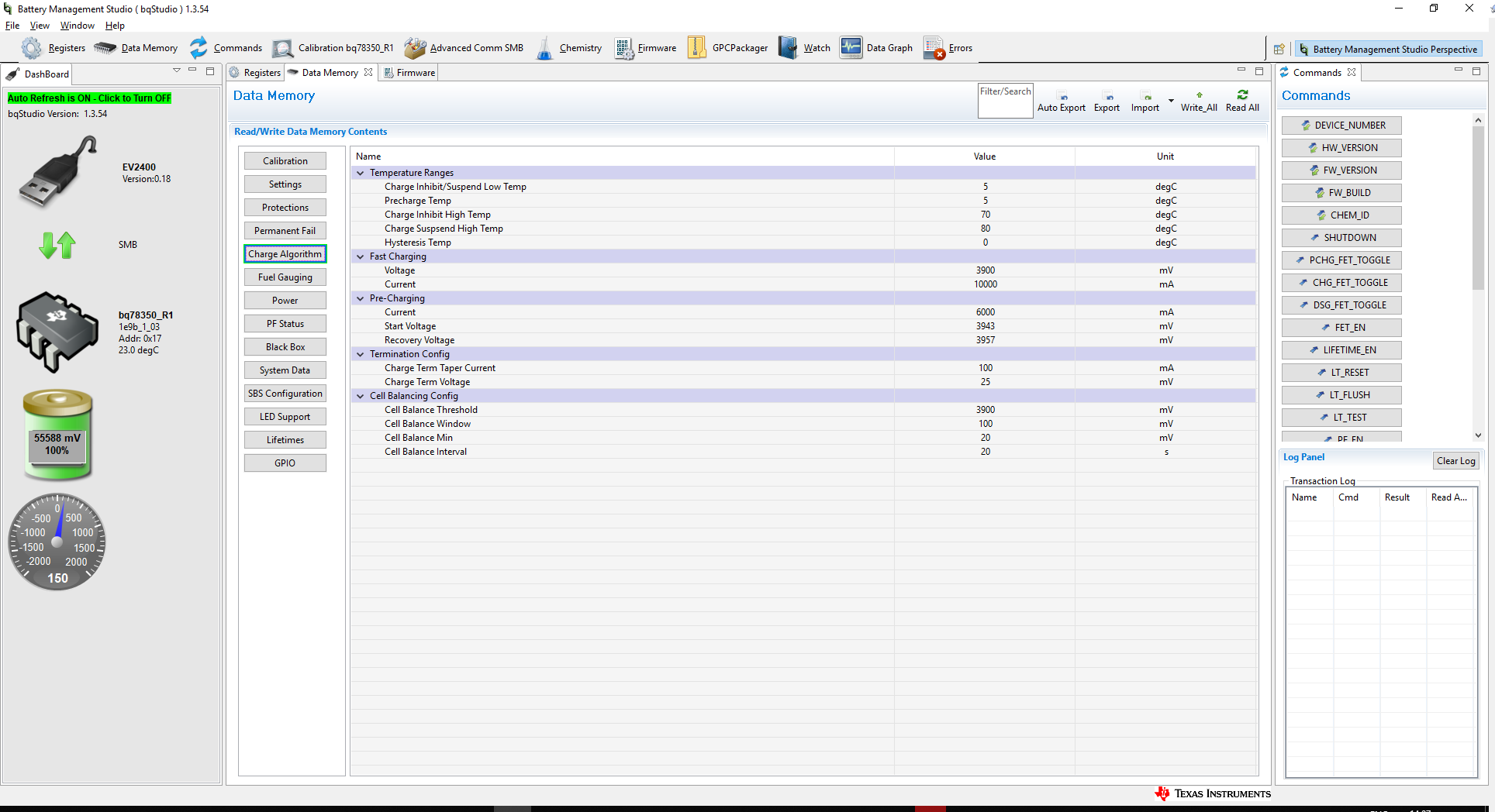

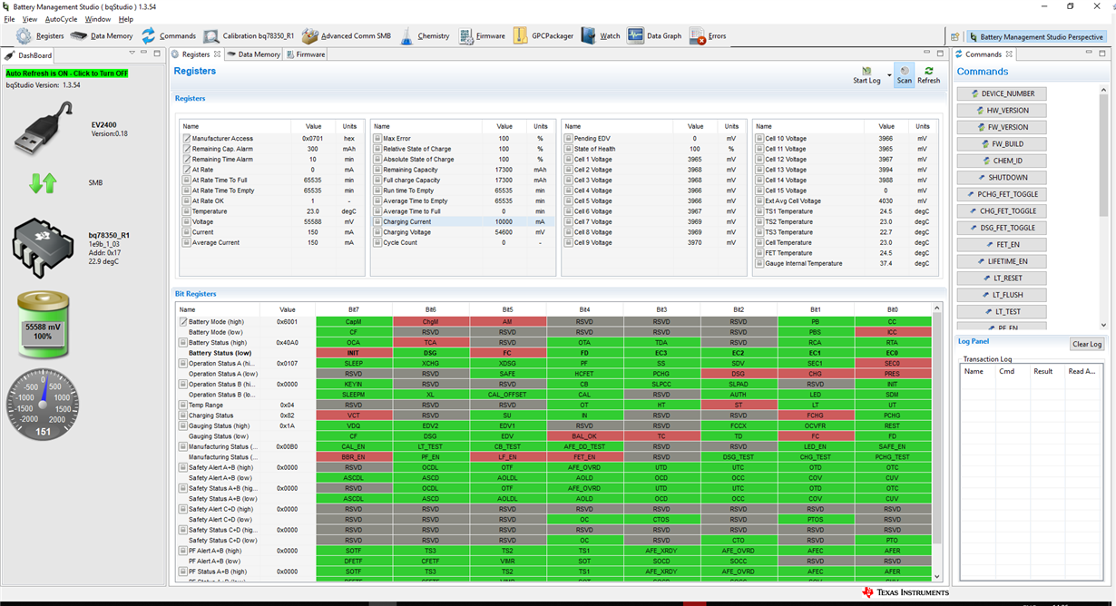

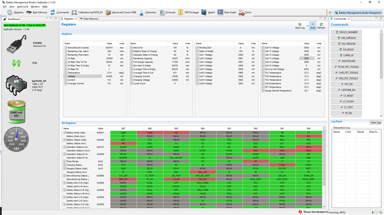

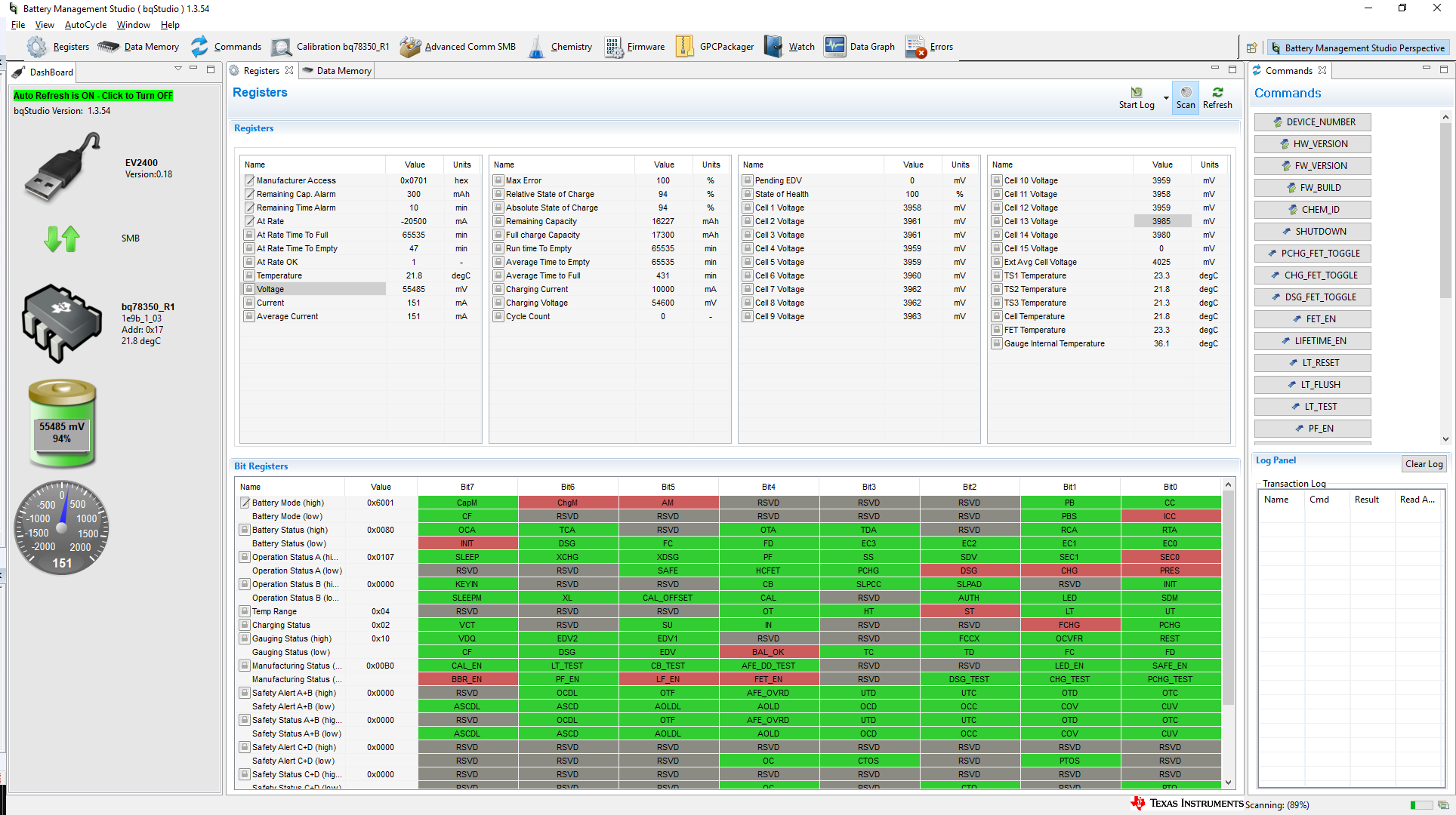

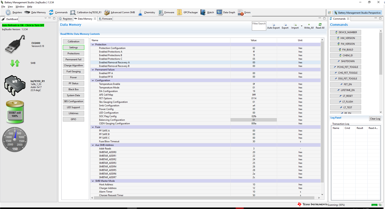

Greetings,
I am working with the circuit BQ7830 and trying to get the cell-balancing to work. with my setup, I have stumbled upon some question marks.
First, in BQ-studio, under the tab "Registers", in the bit register "Operation Status B (high)" there is a bit (Bit4) which is CB (Cell-balancing). Reading the Technical Reference (TR) for the circuit, this determinates the status of the cell balance (if the cell balance is currently active or not). Then there is the Bit4 in the register "Gauging Status (low)  BAL_OK, reading the TR again this bit determinates if the cell-balancing is possible (if enable). Are these assumptions correct? What more exactly are the criteria that need to be fulfilled for these bits to be set?
Furthermore, here are screenshots of the registers and Data memory settings for the cell balance that I have. I also provide the .gg file that I currently use. Any ideas why the cell-balancing is not active?

Second, what happens to the cell balance mechanism once the cells are fully charged and the current is zero. Does it still balance the cells?

  • Hi Matt,
    Thank you for your fast reply!
    Based on the parameters I am currently using for the cell balancing (3900, 100, 20, 20, or see the last previous provided screenshot), what is the limit for the charging current?
    Furthermore, do you have any ideas why the cell balancing does not start in this specific case?
    Michael.
  • Hi Michael,
    I think the charging current must be higher than the Chg Current Threshold in the Gauging parameters section. The default value is around 50mA. Can you describe how you're setting up your experiment? Are you using cells that are unbalanced or are you controlling the voltages with a power supply? The balancing should start as the cell voltages rise above the cell balance threshold and the cell voltages must have a difference of at least the Cell Balance Min.
    Matt
  • Hi Matt,
    I see. I have the default value of 50 mA set for the Chg Current Threshold in the Gauging parameter section.
    To describe the setup for my experiment in more detail, I have 14 Li-ion cells that I charge over the Cell Balance Threshold (3900 mV). At this point, it is not any difference between the individual voltage among cells in the pack.
    Then I charge two cells more (Cell 13 and 14 in this case) to exceed the voltage difference defined by the Cell balance Min (20 mV). At this point, the current charge is at approximately 100 mA.
    See the first provided screenshot in my first post for a picture of how it looks in BQ-studio at this point.
    Do you have any further idea why Cell Balancing is not triggered with my setup?
    Michael.
  • Hi Michael,
    I think the problem might be that all cells have crossed the cell balance threshold before any difference is applied to the cells. When all cells have crossed the threshold, the cell balance threshold increases by the value set in the Cell Balance Window. So the threshold moves as the cell voltages rise.
    I made a video that explains how the window moves as the cells charge. This is for a different device (bq77915), but some of the concepts still apply. You can skip to about 2.5 minutes into the video: www.youtube.com/watch
    Matt
  • Hi Matt,
    First, thank you for linking the video!
    After I watched it, I came up with the idea of lowering the cell balancing window to easier trigger the cell balancing on my setup (from 100 to 20).
    Does the change take effect immediately after it is written to the device BQ-device?
    Furthermore, below is a screenshot after I changed the Cell Balance Window, where the lowest cell is at 3958mV and the highest cell is at 3980.
    Since the Cell Balance Window is now at  20mV and the difference between the highest and the lowest cell is above 20mV my hypothesis was that the Cell Balancing would trigger.
    Unfortunately, I was wrong. Is there any easier way to verify that the Cell balancing is triggered with my setup?
    Michael.
  • Hi Michael,
    I think you may need to do a reset after changing the flash settings for the new threshold to take effect. Also, I think you need to ramp up the voltages from below the threshold. If you try ramping the voltages with the new threshold, can you also click the 'Start Log' button at the top of the screen? This will save a time log of all registers to a file. If you send this file, it may help us to figure out why cell balancing is not turning on.
    Matt

  • Hi Matt,
    I have good news! After I changed the broken battery board I got the cell balancing to work.
    I tried your advice of bringing the cells down below the threshold and then ramping up one cell and it worked.
    You were also correct about restarting the BQ-circuit after changing the flash settings.
