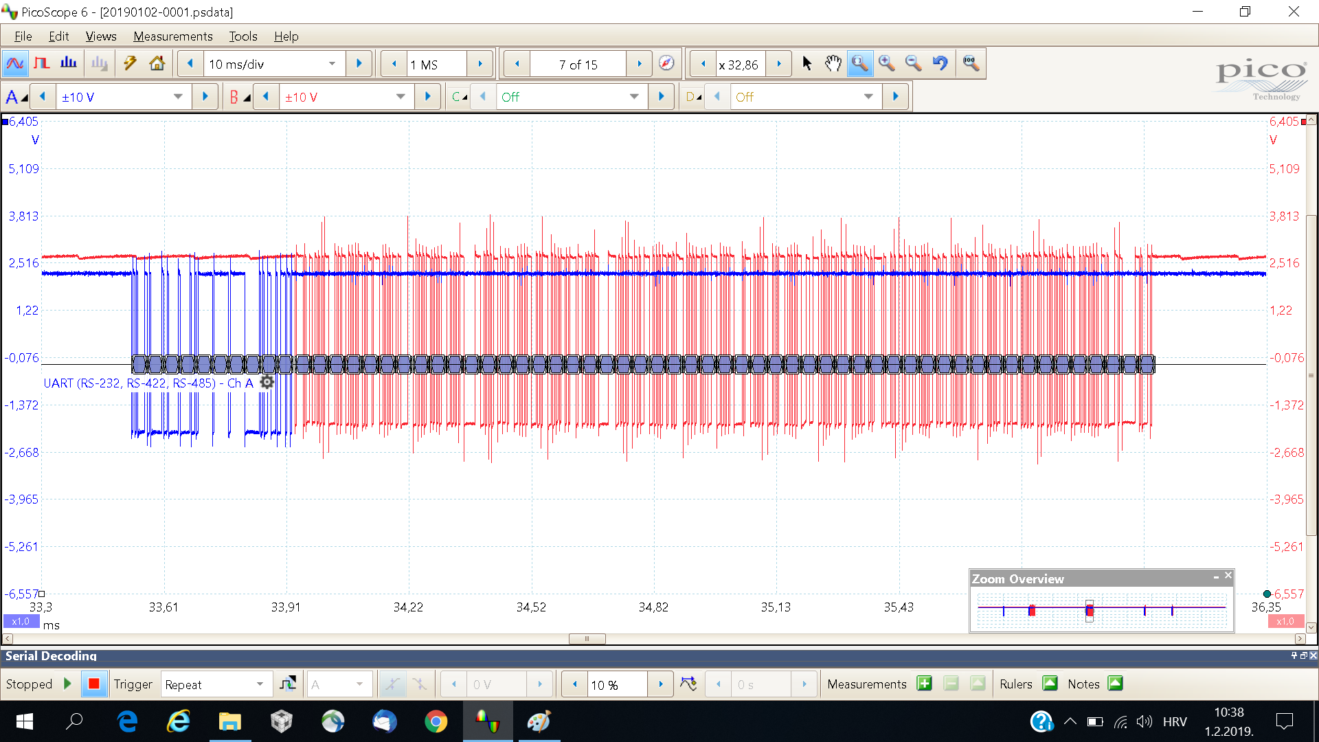

Hi, I am using two BQ76PL455EVMs for monitoring 32 cell voltages in series. I am having an issue in communication when trying to read data from board with adress 1 (upper board). In about 20% of responses i get four more bytes of zeros before CRC. My transmit message is to read 16 cell voltages and 8 AUX voltages. Expected response frame is 51 bytes: 1 byte initialization + 48 data bytes + 2 CRC bytes. Most of the time it is true, but in about 20% of responses i get 55 bytes: 1 byte initialization + 48 data bytes + 4 bytes of zero values + 2 CRC bytes. It only happens when I'm trying to talk to the higher board in stack, and It doesn't happen when there is just one board connected to 16 cells. Could you tell me why this is happening?

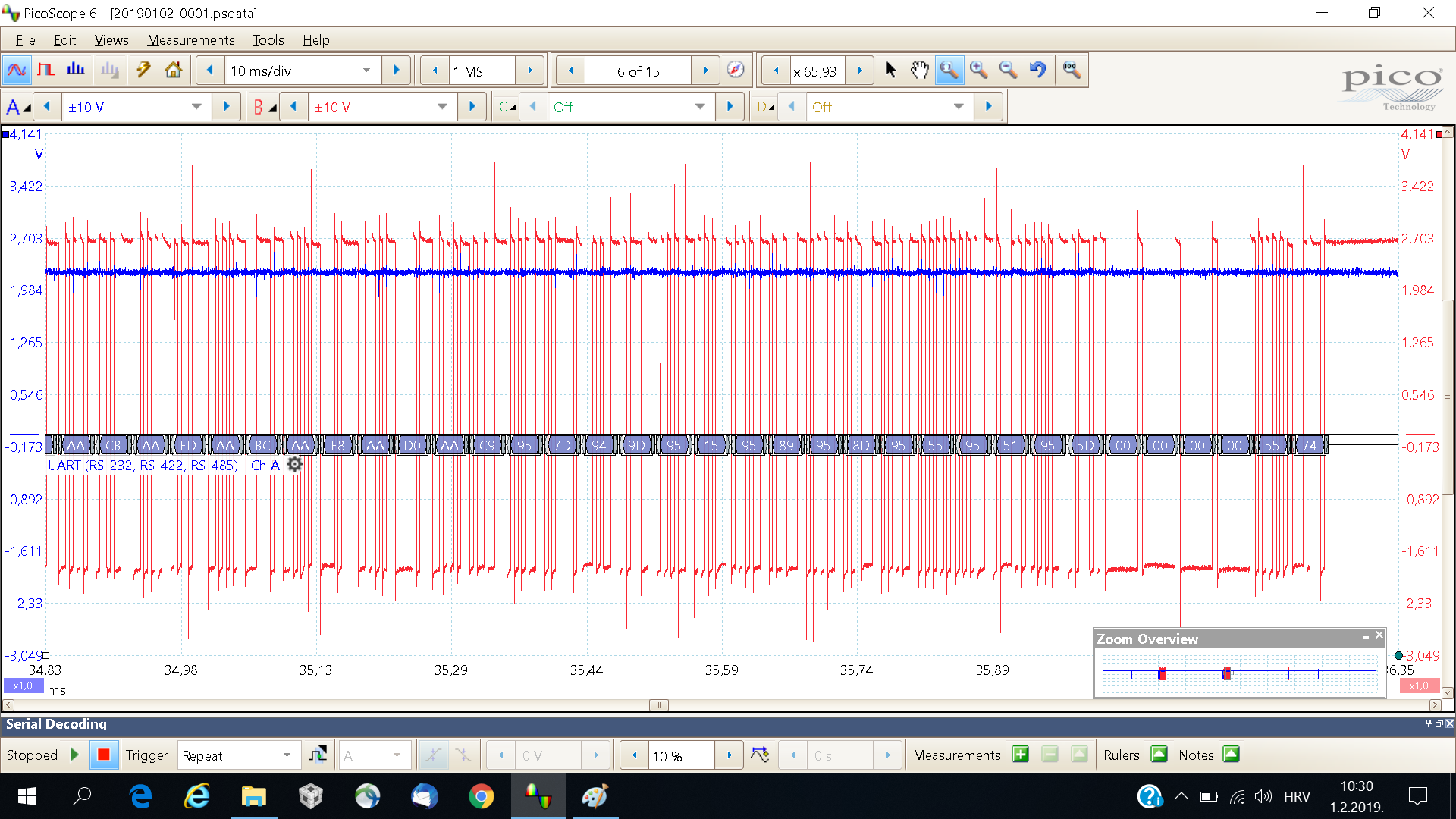

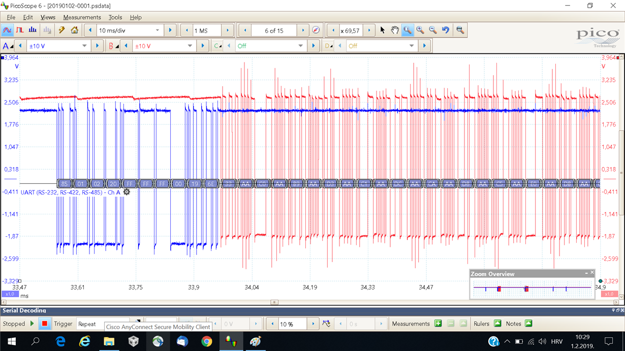

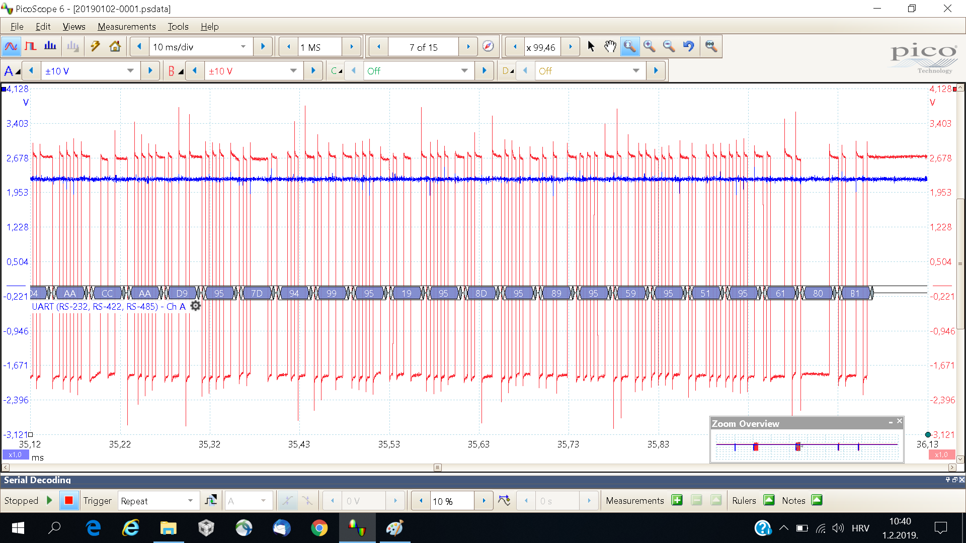

  • Thank you for the quick reply. My hex command is 85 01 02 20 FF FF FF 00 19 6E. One of expected response frames is 2F AA A8 AA DD AA C3 AA D5 AA C0 AA D2 AA D4 AA BD AA E0 AA CB AA EB AA CD AA D0 AA D4 AA CC AA D9 95 7D 94 99 95 19 95 8D 95 89 95 59 95 51 95 61 80 B1. In the three images below you can see the frame recorded by a scope.

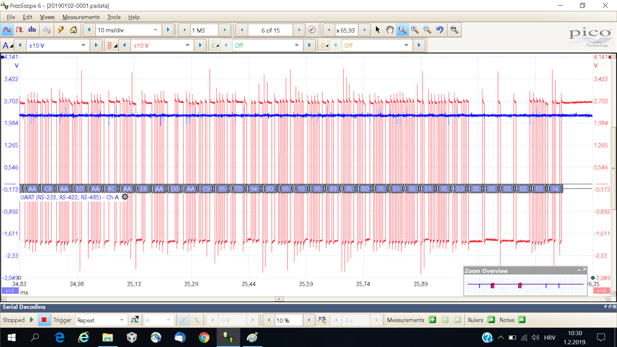

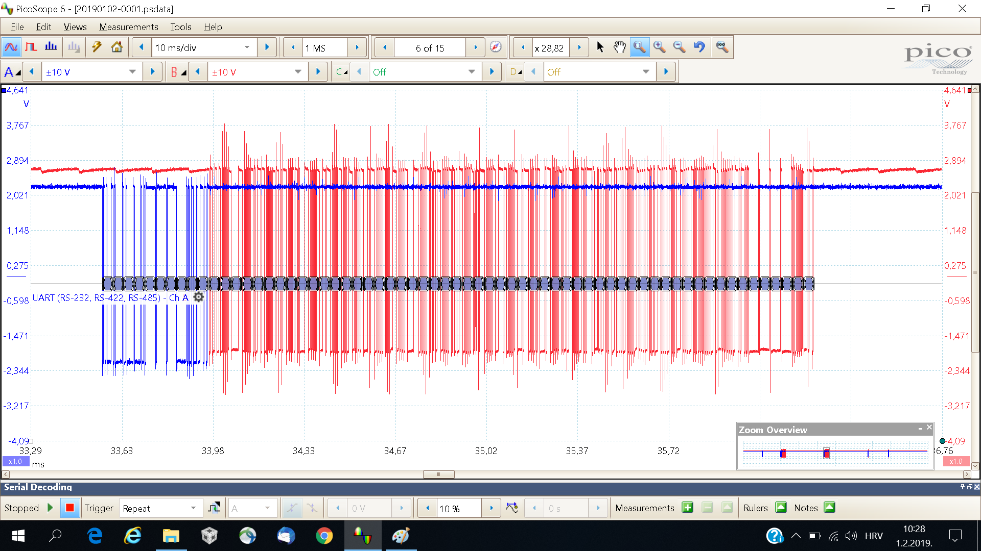

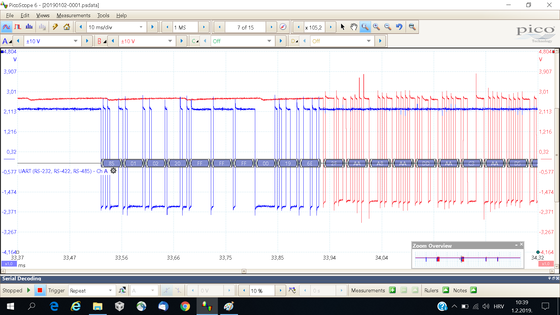

    That was the expected frame. As I mentioned, sometimes the response frame contains four more bytes of zeros. The command frame is the same, the response frame was now 33 AA C0 AA B9 AA D3 AA C1 AA DC AA CA AA D8 AA C5 AA E0 AA DB AA CB AA ED AA BC AA E8 AA D0 AA C9 95 7D 94 9D 95 15 95 89 95 8D 95 55 95 51 95 5D 00 00 00 00 55 74. The following three images show the frame.

    Mislav Blajic
